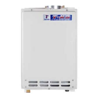

Greetings
Note: My LPG tank is full and my furnace is functioning properly with LPG
Takagi T-K3 LPG
The unit is I’m guessing 15 to 20 years old so it may be at its end ,but if there is a short quick fix - I am all ears
Trouble code: 111
Initially, while taking a shower ,the water temperature fluctuated from hot to cold & back to hot.
Looked in the owners manual under general troubleshooting and it recommended changing the inlet water filter, which I did; fired the unit up and had hot water & figured the problem was solved.
But Nooo…
2 days ago, took a shower and no hot water-not even fluctuation’s.
I then poked around on the Internet looking for information and then found the LED display after I took off the cover and it was showing “111”.
What I have done troubleshooting wise so far:
Pulled both the igniter and flame rods ,sandpapered rods and visually inspected: no cracks or chips in the ceramic bodies & the rods are tight in the bodies.
Checked for spark coming out of the ignition rod and am getting said spark.
The site glass window is grungy and am unable to clean,so I can’t see if there is an initial spark or flame.
When cycling, the fan turns on then the gas valve self tests-“clunkCLUNK-clunk-clunkCLUNK-clunk-clunkCLUNK-clunk”, then the fan RPMs will increase and the LED trouble code will be displayed.
Possibly a fuel supply issue as there’s air and spark but may be no fuel to complete the combustion.
Is that small then loud “clunk” with the gas valve normal?
I’m wondering if the gas valve is suspect(?)
Sooo…
That’s where I’m at;any recommendations and suggestions are greatly appreciated.
Thank you

I would replace the flame rods and ignitor, those are in poor shape. I've also seen where the gasket is worn and the ignitor is loose enough to move away from the burner and not spark. New flame rod assembly comes with a new gasket.

With the soot on the flame sensors need to take a inspection mirror see what the heat exchanger looks like. Burner might need to be cleaned and combustion fan.That clunk gas valve opening and closing from a bad flame signal
I pulled the burner unit and it’s very dirty- some rust spots ,lotsa crap in the fins , corrosion.
I tried uploading a picture but it’s too big a file.
I am leaning towards buying a new burner unit- is that something you would recommend or are these pretty stout and just try cleaning it up?

Most manufacturers recommend using compressed air at 120 psi to blow out the burner. It's already open I would definitely attempt to clean before a large expense like burner replacement.
