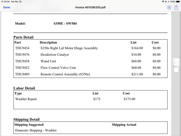

But what really impressed me is the invoice they sent me...
They included a new carbon filter ($27 ) and a new remote ($140 ), plus other parts for free! Shipped it back via FedEx for free.
