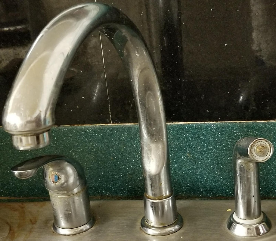

I have a Delta Kitchen Faucet Model 172-WF which the model information was provided to me by Delta Faucet Customer Service many years ago. I have a problem which had been since I bought the house in 2009 and now where it seems that when I turn the faucet on, for the first 10 seconds, water would flow out below the handle so it is not a leak, otherwise it would continue for more than 20 seconds with the faucet running. Delta said only RP4993 is really needed while RP3614 as a repair kit has other things in it, none of the other items other than the spring and the rubber seals could be used other than the tool. I did buy RP3614 and replaced the 2 rubber seals and the 2 springs but have the exact same problem as before I replaced them. Does anyone know what else I can try since it seems Delta said it is not a cartridge issue.
Replace the cam and packing. It's the grey piece with the triangle opening for the stem.
most all Delta's seat/springs valve have an adjustment integral with the retaining cap to allow tightening of the seal
