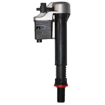

We have a Toto Soirée toilet in the master bath that is 4 1/2 years old. Lately it has begun to make a horn or whirring sound at the end of a flush. Sometimes it will make the same sound out of the blue without flushing. What could it be and how do we fix it? Thanks for any information.

Do you mean at the end of the fill rather than at the end of the flush?
If so, I would see two possible problems. Your fill valve may need a replacement piece. Plus maybe your flush flapper is leaking causing a fill to occur periodically. See if the tank water level declines between flushes.

It's the fill valve. Does yours look like the one below?
Korky 528T Replacement TOTO Toilet Fill Valve - Fits G-Max and Power Gravity Toilets -Easy to Install -Made in USA
(Ignore the cap color, I'm just talking about the general style.)

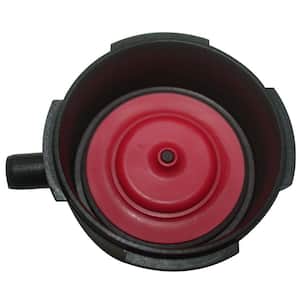

If so, you can fix it by replacing this little cap inside it:
It's Korky Part R528, and it's available at HomeDepot, among other places:
http://www.homedepot.com/p/Korky-Toilet-Fill-Valve-Replacement-Cap-R528CM/202666007
Here are the instructions on how to service your fill valve, and you can swap the cap when you do so.
If you don't have this style of fill valve, the valve isn't easily-repairable, and you need to replace it with the Korky 528MP. (Toto uses 3 different manufacturers' valves, and they are entirely-interchangeable, but the Korky is easiest and cheapest to fix.)
You can get the Korky 528MP MaxPerformance fill valve at Home Depot and online. http://www.homedepot.com/p/Korky-QuietFill-MaxPERFORMANCE-Fill-Valve-528MCM/203145423
You want the MaxPerformance one, with the silver top, not the white one or any other color. The others won't properly-refill the bowl. You can also replace it with the Toto TSU99A.X universal replacement fill valve, which is a Toto-branded Korky 528MP, made by Korky for Toto, that costs more but is essentially exactly the same.
It should take less than ten minutes to change the valve.

Our pleasure! One thing I should have said is that if you have the valve that looks like the one in the picture, it will probably say "Toto" or "EMax" or "GMax" on the top of it. It's made by Korky even if it says "Toto", so don't worry about whether the R528 cap will fit it. I was once actually curious myself whether that R528 cap fit all of the different flavors and re-brands of the Korky 528, and the answer is "Yes." It's pretty ingenious: all the "wear parts" (i.e. the stuff that will wear out over time) are in that little cap, so (in theory at least) you never again need to change out the whole fill valve; you just replace the cap when it wears out, a couple-of-minutes job. How often that happens depends upon: (1) how high your peak water pressure in the house goes, (2) what the chemical composition of your City water is; and (3) some measure of luck.
