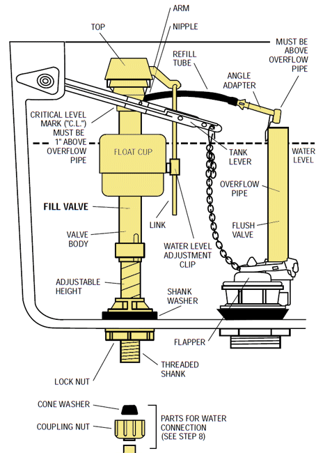

Hi all. I had a leak around where the water line goes into the bottom of my toilet (regular 'ol toilet..nothing fancy or different). I replaced the water line and also replaced the flush valve (twice). The first time I replaced the flush valve, I was still getting a leak around the connection up around the bottom of the water tank, so I replaced again. I am still getting a few drops that are leaking around the connection and trying to figure out what the heck is wrong. I have tightened by hand as the directions say not to 'overtighten" or you can crack the tank. I am female and not the strongest cat in the fight, so I had my husband turn by hand as well and we are still getting a leak. Any thoughts on this besides calling a plumber?

The thing the water supply hooks to is called the fill valve. The flush valve is the thing that usually has a flapper on it.
I suspect the leaking continues when the tank is full and you turn off the supply valve. In that case, the leaking would be at the gasket at the base of the fill valve. If you tighten the nut down there by hand, you are not going to crack the tank. You might strip the threads on the plastic fill valve however. I would start by tightening more with your fingers. If you did strip that thread, it would not be terrible if you can get your hands on another fill valve readily.
If tightening more by hand does not do it, there may be a flaw at the hole in the tank on the surface where the gasket/shank washer sits. You can remove your fill valve again, and feel around. Sand down any imperfection in the surface. Then apply some plumber's grease to both sides of the washer/gasket, before tightening again.

Thank you for that. Yes, the leaking is occurring while the tank is full and the water is turned on. Since water runs downhill, at first, I thought I had leaking around the water line where it comes out of the wall...but after further inspection, it is indeed leaking around the threaded shank/lock nut.
Normally with a new fill valve, supplied with a new rubber shank washer there, you would be fine. I check for roughness on the inside of the tank to make sure that there are no rough spots there.

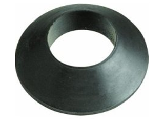

The shank washer in the diagram. Beveled part downwards
You might want to elaborate on that. I figured those were flat. So any way, you are saying the smaller diameter down?
