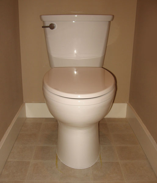

For entry level I like the TOTO Entrada.
ADA height, 1000 grams on the MaP testing. Standard parts in the tank, good bowl rinse and very good quality control.
Most plumbing wholesale houses should carry them.
For the Seattle area I have this link.
http://terrylove.biz/toilets/99-toto-cst244ef-entrada-toilet.html
This is a standard Bemis seat here, but we normall install with the SS114 Softclose seat.
Seats are pretty generic though and you have plenty of options there.
