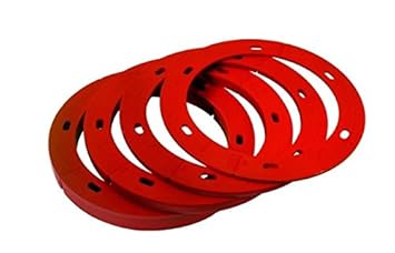

1. I have a Sioux Chief SS flange that goes into a 3" pipe. The PVC pipe comes up through a tiled floor with an almost perfectly sized hole for the pipe. But....the closet flange has a ridge at the bottom, inside the SS metal ring, that prevents it going through this hole and leaving the metal part on the finished floor. Should I plan to make the hole wider, which will generate copious amounts of dust and weaken the tile, or can I shim the metal part of the flange? I'm tempted to ask a metal fabricator to make a ring that goes under the metal ring in the flange. Parenthetically, why is something that sells in the hundreds of thousands if not millions so badly designed?
There are a lot of plastic toilet flange spacers available that can go under a flange ring.
Do you have an example of one of those?
https://terrylove.com/forums/index.php?threads/toilet-flange-spacer.66058/
http://www.siouxchief.com/products/drainage/residential/closet-flanges/spacer-repair/raise-a-ring
https://www.oatey.com/2371066/Product/Oatey-Closet-Flange-Spacer

Thanks, this Set-Rite spacer kit looks like just what I was looking for (no need for the flange extender, I'm not below finish floor height), only question is if it is the proper diameter:
