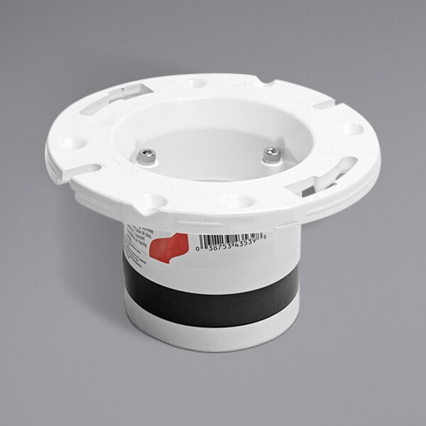

If it is 4 inch cast you can just get one of those expanding Oaty flanges that you set into the hole and
use an allen wrench to crank down on the flange to secure it.... they work pretty well but I suggest you glue it
down to the floor when finished with Alex Dap
on occasion they sit too high but its worth the try
