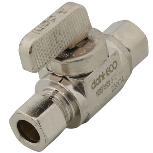

Hey all,
The 1/2 copper has shut off with 3/8 compression that navigates through the filter to the faucet. I would like 1/2 flow to the water hose spigot and 3/8 to the filter/faucet. I'm thinking both should have a shut off but am open to other recommendations. The water hose pipe has to rise 5" vertically and 50" horizontal from current shutoff, through a concrete block wall with plywood sheathing and vinyl siding. I'm interested in connection methods other than sweating copper pipe (I've never done it). Open to being schooled.

Add a "Add-A-Tee" to your existing supply valve. At this part you can use a "Add-A-Stop". This would give the a independent stop for the hose valve.

So if no other way use add a tee fitting like above .
