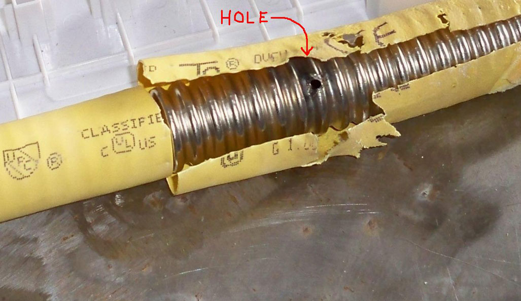

The yellow flex hose was just installed two days ago. What should I look for, in terms of the metal fatigue?

It's a little hard to tell visually, but if the flex line has been flexed too hard in that kink it'll be less flexible or springy than the rest. I'm not totally sure what the minimum allowable bend radius is on that type of line, but it looks like a pretty sharp turn. These folks specify greater than 3" bend radius for 3/4" line, yours looks like less than 2":
A coffee mug has a radius of about 1.5", and it doesn't look like the one on my desk would snug into that arc, not even close!
Normally it would have enough extra to allow for some mechanical compliance/flex in the event of an earthquake, etc. If it flexes or pulls hard enough to create even a tiny crack, you may end up with something like this (after your garage gets scattered all over King County):
Take a good hard look at it- measure the bend radius if you have to. A t
