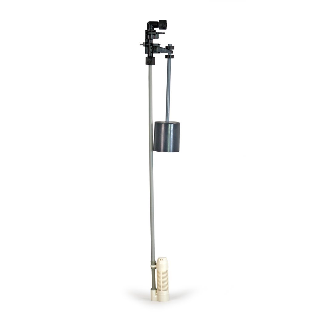

If the safety float is being lifted high enough to cause the safety valve to close, then less brine than required will be produced, and so the brine will be drawn in less time than it should, and less than 36K capacity will be regenerated.
Check to determine if the safety float's lower limit ring maybe moved downward on the rod to allow the full 4+ gallons to enter the brine tank without causing the safety valve to close. The float may rise higher than it does currently, but as long as it is not closing the valve while there is the proper amount of brine in the tank while the tank is filled with salt, that will be OK.
Because the float will rise higher than before the adjustment, the plastic rod that is attached to the topside of the float may rise higher than the top of the brine well. Since the brine well cap and brine tank lid could prevent the float from closing the safety valve, the top of the rod may need to be trimmed shorter to allow the float to rise sufficiently high enough to close the safety valve when required, without the rod making contact with the brine well cap. When trimming the rod, the upper limit ring may need to be moved lower on the rod. The upper ring is utilized to support the float while it is hanging, and also to allow the float to reopen the valve once the brine level has fallen.

I think I have a different style valve than you are expecting. This does not appear to be adjustable. Was extremely easy to pull, thanks for the idea. Measuring from the bottom of the air check up to the slightly scummy line on the float while holding it up yields ~ 19.5". I don't know how much water is under the air check when it's installed...I could probably figure out if you needed me to based on the mounting hole in the tube in the tank.
Yes. The version I described is shown below. I have no experience with the version you show, so I'm not certain how the float and valve would be adjusted, or if that is even possible.
The chart linked below, specifies an 18" X 33" brine tank will hold up to 350 lbs of dry salt, and each inch of liquid brine will contain 1.2 lbs salt. For your 12 lbs salt setting, there should then be approx 10" of liquid above the line on the air check screen.
Since it seems the current amount of brine significantly exceeds 10", suggest either removing the BLFC flow restrictor button to view the number on it to verify it is actually a 0.25 GPM BLFC or, disconnect the brine line at the top of the tank, advance the controller to the Brine Fill position and measure the amount of water exiting the open brine line over 60 seconds. If the BLFC button is actually a 0.5 GPM version, your BF setting minutes will need to be reduced by 50%.
Edit to add: The BLFC button is directional. When reinstalling it after viewing the number, ensure it is inserted with the number facing toward the control valve.
