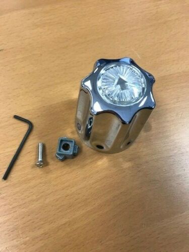

Many "universal" shower knobs have an adapter that attaches from the side with set screws. You might have to cut off the welded screw.
