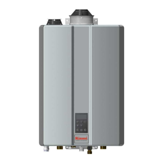

Well my luck ran out (or came in, depending on your perspective). The water heater started acting up a few weeks ago, and rinsing the sensor with tap water only make the problem go away for a week or so.
So I purchased a new sensor (out of pocket, don't have time to spend to convince Rinnai), and voila transient pressure dips go away completely.
Given I now have a completely redundant sensor, I decided to open it up and found that the pinhole was almost completely covered in scale, so much that I originally thought the scale was part of the sensor itself.
There was no component marking on the PCB, but if I have to guess, the pressure sensor part is this (based on looks): Digikey
In 1.5 year or whenever the new sensor starts acting up again, I'll put this old sensor back and see if I'd broken it.

To be clear, problem was solved. Pressure sensor was dirty, the transducer hole was caked with what I presume is dissolved minerals. Purchased a new sensor and the problem went away. I then thoroughly cleaned the old sensor, and tried to identify the pressure transducer part so if this happens again I can reuse the old sensor.
Nothing to do with plumbing arrangement, though perhaps related with the use of black iron fittings..

Disconnect the sensor wiring to avoid ripping it accidentally. Isolate the boiler then drain water from the boiler before you undo any of these clips so you won't get sprayed (and the tension relief makes it easier to undo the clips).
You need to remove that section of piping from above the pump by pulling the metal tab that you circled in red. And then there's another clip where the piping enters the heat exchanger (just above where you circled in your pic). Pull that out too.
Once you got the pipe section off, the sensor is secured with 2 Philips head screw. Undo and open the sensor plastic cover. You may decide to strip it to bare PCB at this time to get better access to the actual sensor itself. I bought a spare sensor just in case I f it up during disassembly.
Also the grey cap ontop of the pump is air bleed valve. It looks like it is/was leaking. Manual says to leave it open for a week (if memory serves) then screw it tight to close.
After you reassembled everything, don't forget to run the bleed program (see your manual on how to trigger that). This requires that grey bleeder valve to be open.

Thanks for telling me this is a common problem. This tells me the sensor is flawed. They should've picked a sensor body with different material, one that doesn't react with dissolved minerals in water. If I crack open my boiler again I'll make a video.
Another important point I wanted to make; some suggested flushing with vinegar as a solution. Flushing the DHW loop will NOT work. And the manual specifically states to NOT flush the primary CH loop, which is where this pressure sensor is.
