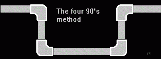

Could you address my question on #6? I think that has a lot of bearing on what the right fix would be. I think discussions have presumed that this was not at the end of the line, but was between two sections of PVC pipe. For that, I like the glued fix that involves four glued 90s. That actually improves the thermal expansion/contraction handling vs a regular glued PVC coupling. But I certainly see merits in the alternatives. The exception is that I would avoid the PVC repair coupling (like a regular PVC coupling, but with no stop in the middle). That seems like that would be hard to get right the first try.

The 4-elbows method.
If the PVC run is longer, this can also allow some flexibility in the face of thermal expansion and contraction.
