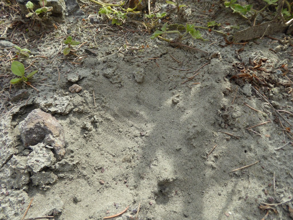

The driller came back to pull the pump out and try and airlift the sand out, but it was too solid to shift.
Was what the driller did was to use a realy big compressor and blow air down the hole creating a geyser, or was it a pipe and hose system called an air lift pump and a smaller compressor?
Is your sand really green? It is not important for the purpose, but I am just curious.
Sounds like to me that the driller should have used a finer screen for the PVC. I am not a pro.

The drillers turned up with a massive compressor, towed behind a truck. They connected this via a small (around 3/8" maybe 1/2") airline to a sort of home made air injector. This looked to be a bit of taped clear air hose poked into a bit of 1" PVC rigid pipe. They screwed together enough lengths of this 1" PVC pipe to get to the packed sand layer, taping the air house to the side of it all the way. They could only crack the compressor valve open a fraction, as the truck-sized compressor they had was way to big, I think. All that happened was that the end of the PVC pipe got stuck in the packed sand and very little sand/water came up. If they lifted the pipe up then it would spurt water out, like in one of those videos, but very little sand. After I'd been paying them for around three hours, with nothing to show for it, I told them to pack it in and send me the bill.
The problem here in England is that there just isn't any real expertise in drilling well/boreholes, and once you have one drilled by one company, no other company wants to try and help out. It's a real headache trying to get hold of people who know what they are doing, so I've really been stuck trying to do a DIY job, with the aid of advice from forums like this.
The screen size may be a problem, but the driller reckons that the running sand should pack up around the crushed glass media and form a filter. I'm personally convinced that the real problem was that the driller didn't develop the well by pumping it hard as soon as it was completed, as I've read (and it could be wrong) that this helps to pull the fine sand out and allows the coarser sand to pack around the glass media to form a filter around the screen.
Yes, the sand really is green, a very dark green. It's pretty fine and settles to form a very hard layer.

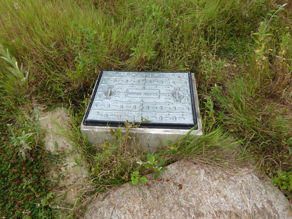

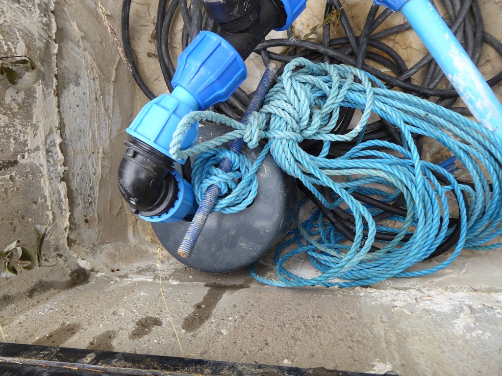

Just to give an idea of what I'm dealing with, this is a photo of the well head pit:

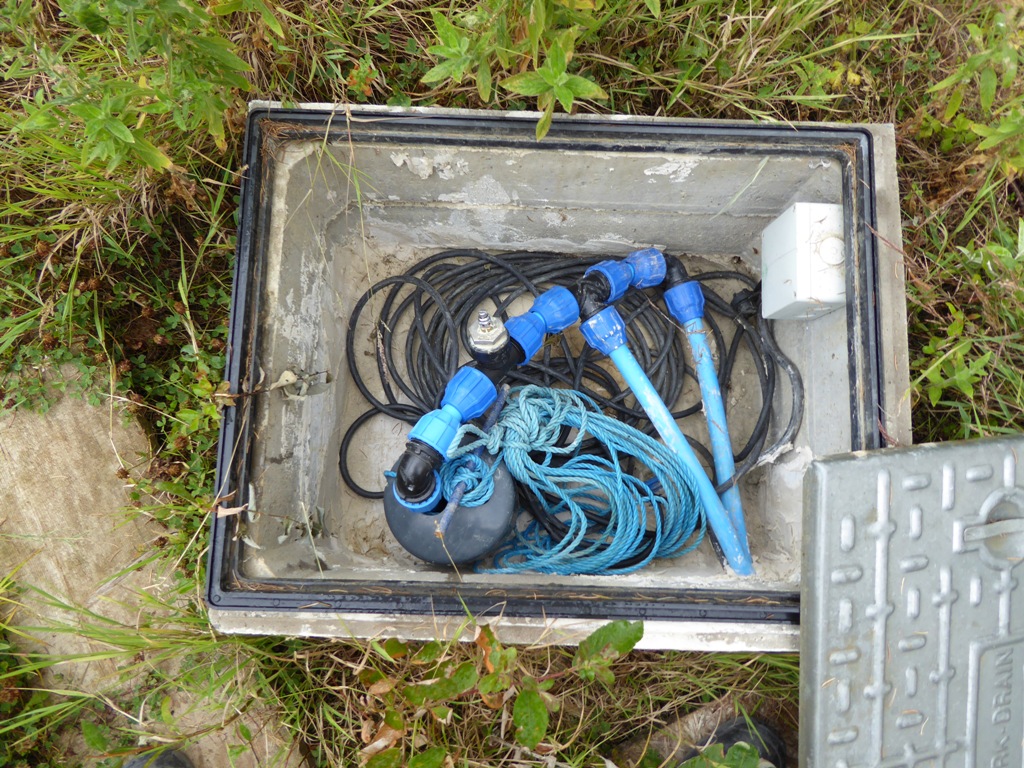

With the lid lifted this is what lies beneath:

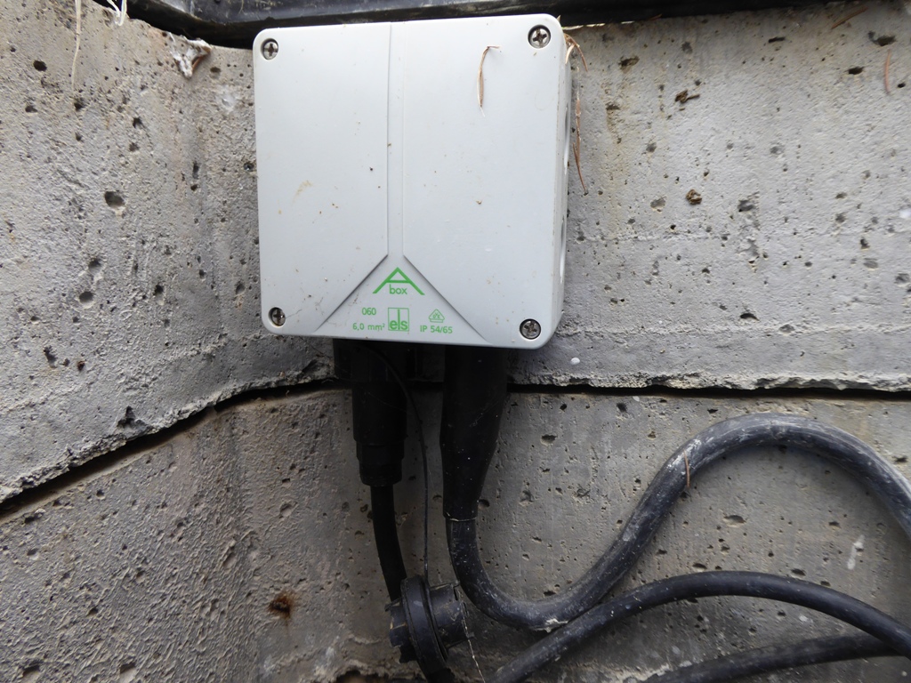

There is an electrical box screwed to the wall of the concrete pit that has an armoured cable coming in (to the right of this shot) and a waterproof connector that allows the pump to be disconnected completely pretty easily (I added this, as the original electric connections weren't waterproof and looked seriously dodgy to me).
The well liner is a 125mm OD PVC pipe that at the moment has a poorly fitting 140mm ID plastic cap over it, with the pump pipe, safety rope and cable coming up out of it. It ain't pretty and is frankly a mess. There's a flow restrictor in the tee and I had a gauge on it for a while, and that air vent has since been replaced by a pressure relief valve set to 95 psi to protect the pump should the pressure get to high (after a contributor here kindly pointed out the dangers of "dead heading"" the pump accidentally). The two pipes to the right run to underground ducts, one feeds the outside tap one feeds the treatment plant in a shed on the back of the house and then to the house suppy. The pipe work in the pit isn't good, with a LOT of strain on the fittings, which is one reason I want to tidy it up.
It's hard to see, but there is a bit of perforated land drain pipe set into the tapered concrete cast base at the bottom that connects to a big soak away drain to keep the pit dry (it used to fill with rain water, as the top soil is clay).
The plan is to get rid of the pipe that feeds the outside tap and re-plumb that tap with water taken from after the iron filter. I'm going to leave the pipe there as a spare duct, maybe to feed a cable back into the house with a remote level detector or something to read out the water level in the borehole (nice to have, but way off in the future, if ever).
I've purchased a 125mm ID PVC flange fitting, that fits nicely on to the 125mm liner, and I've machined up a bit of 5mm 316 stainless plate as a cover flange, with holes drilled to take a pipe fitting for the pump pipe, a stainless eye bolt for the safety rope and a proper gland to protect the pump cable. I've drilled 6mm holes around the edge of this and drilled and tapped the thick PVC flange to take these. I've also added a stainless steel lifting eye to the top, to make pulling the thing up easier (although it's not that heavy).
I have the pump pulled out at the moment, ready to fit the new cover and connections and I'm going to have another go next week at pumping the sand from the hole with an air lift. If this works, then I may leave the air lift pipe and air pipe down the hole, but under the flange, as the small Grundfos pump will fit in there with the air lift pipe in place and it may give me a fairly quick option to just hook up the compressor now and again and suck out any more sand that gets in through the media pack and well screen.
I'll update this thread with photos of the new well head arrangement that I'm hoping will be a lot neater looking than the present arrangement. With luck I may well have pumped out all the sand at the bottom of the well by then, too!

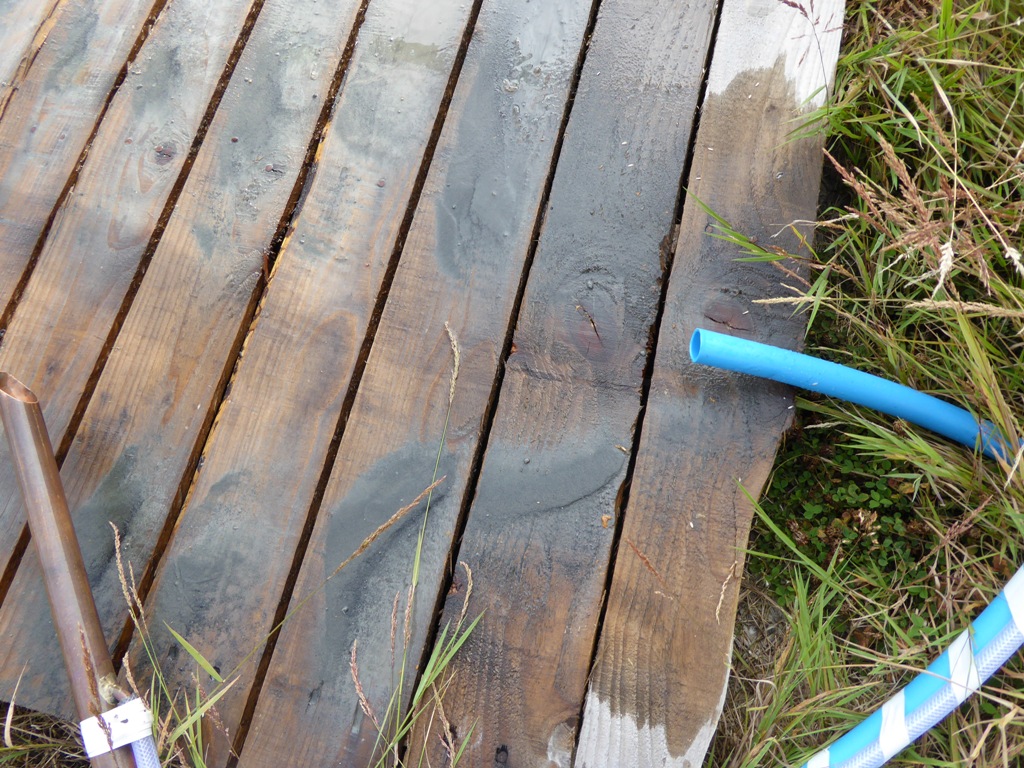

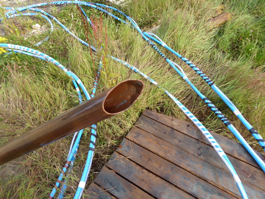

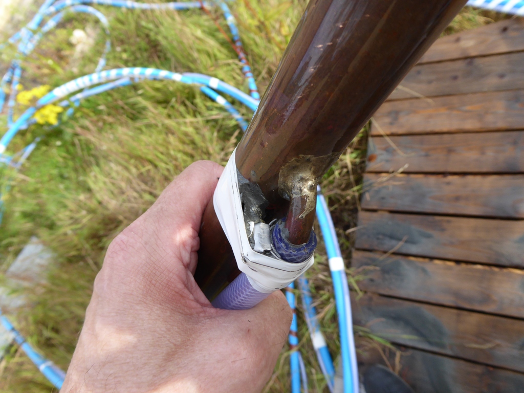

Thanks, I did try a few, but found that the settling time is too long for them to work. First off, I imported the Lakos sand separator, with the spin-down filter, but this just let the sand straight through the 74µ mesh with very little getting trapped, just the heavy stuff ended up in the collector at the bottom.
Next I tried a much bigger Cintripur centrifugal separator, but again the very fine sand went right through. If anyone in the UK wants either a Lakos or Cintripur centrifugal separator then they can have mine for free, as they wouldn't work for my problem. I'm sure they work very well with regular sand problems, as they both seem to have a good reputation, but they just don't work with the very fine Greensand we have.
Next up I tried filtration, but the sand would go straight through a 25µ filter and clog a 5µ filter in minutes, even the washable pleated polyester ones in the 20" Big Blue housings. One of the best companies I has advising me (and trying to sell me their spin down cyclone separator) were great, they were determined not to sell me something unless they had a good feeling that it would work. They had me do a series of settling time tests, to see how long the water took to go from dark grey to clear. I did these using clean clear glass wine bottle (it was US wine, too, a Californian Pinot Grigio that was, I have to say, a very enjoyable way of getting test containers..................).
I set up to do these settling tests with my digital camera set to take time lapse photos, with the clear bottles against a white card background. This worked great, but showed why the sand separators weren't working; the water was taking between 4 and 8 hours to settle clear, so the particle size and mass was just too small and light for the centrifugal systems to work, I have to give it to the guy trying to sell me the expensive spin down cyclone system, as soon as he saw the results he said right off his product wouldn't work and he had doubts that any spin-down filter would work.
I then got my drillers back in to try and clear the sand from the hole. I won't go into details, but they were nice guys and their attempt to pump the fine sand from my borehole (there's around 20m of it packed in the bottom) failed, for several reasons, not least of which was (putting it politely) their rig was crap. I've now read up on sand lifters from loads of useful web sites (all in the USA for some reason - you guys over there dominate the world in well technology you know!) , and made my own - it's getting tested out next week - wish me luck!

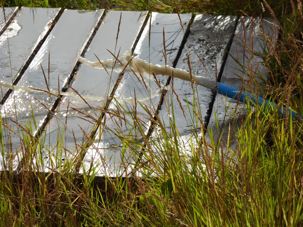

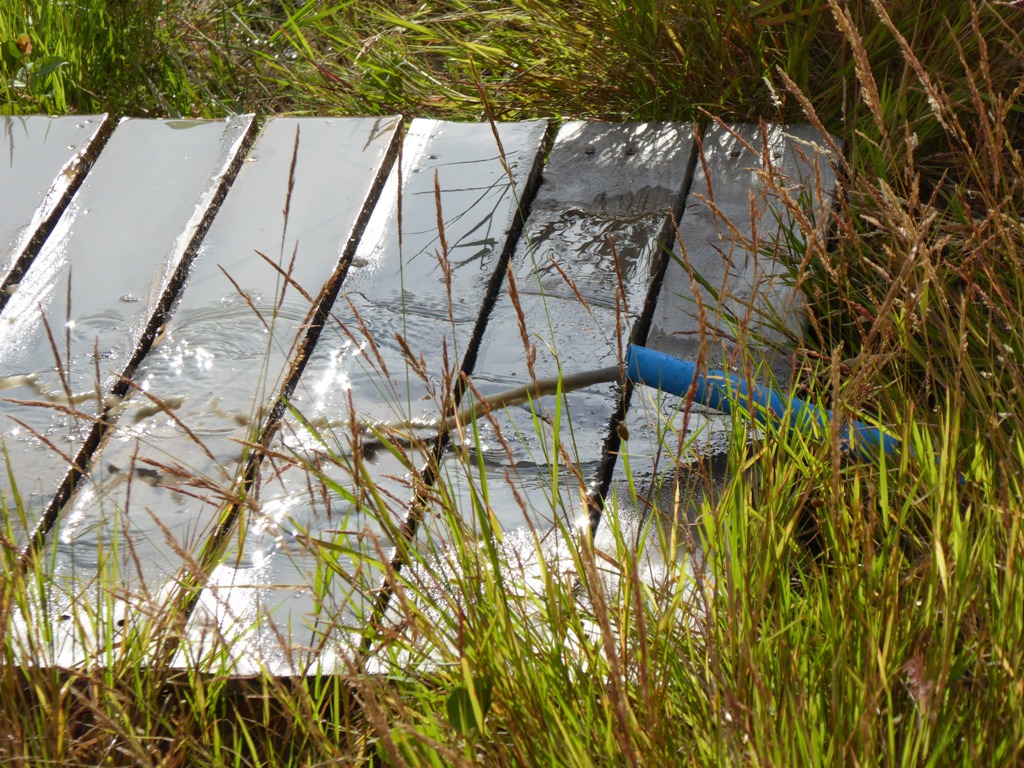

Next up in my train of experiments was a two tank set up, where I pumped from the borehole to a 650 litre tank fitted with a float switch, then pumped from about 1/3rd of the way up the 650 litre tank with another pump to feed the house. At the same time I fitted a venturi air injector to the feed from the borehole, that restricted the flow but helped oxidise the iron and drive out the smelly hydrogen sulphide. This worked well, but could only be temporary as I have no room for the second tank and had to stand it on the back path whilst I was using this set up, where it got in the way.
I learned several things from doing this. Pumping at full rate (without the air injector venturi fitted) filled the tank with cloudy water with loads of sand in it, and it never got long enough to settle before it'd get drawn into the second pump and iron filter. Fitting the venturi fixed this, by throttling back the pump flow. I found (after loads of experiments, moving the pump up and down the hole, changing the flow rate by throttling the pump with a valve etc, that with the pump 25m down the hole and a flow rate of not more than 10 litres/minute I ALWAYS got crystal clear water. I've been treating these as magic numbers, as I can pump all day (literally, I've just left the tap running all day) at 10 l/m and the water is always clear. with no sand or sediment at all.
Another thing I learned is that air injection works exceptionally well at getting rid of both iron and hydrogen sulphide. Furthermore, when I added a home made ozone generator to the venturi air feed the results were outstanding, the oxidation was very rapid indeed, such that the clear section of PVC I fitted straight after the venturi went brown with rust within a few hours. The taste of the water improved massively too, it really was the best water I've had out of a tap in a house (not saying much, though, as our municipal water supplies are often highly chlorinated and taste awful).
So now I had learned a lot of useful stuff:
1: I have a LOT of very fine (between 5µ and 20µ) Greensand that gets through my glass media pack, though the slotted liner and through a packed layer of (I guess) coarser sand that is covering all of the slotted lined screen section. There are no gaps in the liner; it's screwed together sections of 125mm PVC and I've had a video camera survey, and all is nice and clean and tidy until the packed sand layer at about 45m down a 65m deep borehole.
2. The fine sand takes 4 to 8 hours to settle out, and so centrifugal sand separators don't work and I don;t have the space for staged settlement tanks (I did sort of consider it, as a sort of garden feature, but She Who Must Be Obeyed said NO.................).
3. Conventional filters clog too quickly. It even clogs the mixed media sand and Aquamandix iron filter I have within an hour or two, slowing the flow rate right down until I back wash it (luckily the stuff is fine enough to backwash out OK).
4. Oxidation works really well at cleaning up the hydrogen sulphide and iron problem and adding a bit of ozone makes a massive difference to the effectiveness of this.
5. Keeping the borehole water flow rate down below 10 l/m means I always draw clean water. To get enough to backwash the iron filter I've fitted two 300 litre pressure tanks, charged to 5 bar with a 4 bar pump cut in pressure and a 2.5 bar pre charge. This works well, I get enough backwash water from the tanks and just have to make sure they are fully charged before the backwash. This I do with a simple time switch that turns the pump pressure switch power off for five minutes half an hour before the timer backwashes the iron filter. Turning the power off and on again like this triggers the pressure switch to always turn the pump on until the 5 bar cut off is reached.

Today I tried my home made air lifter to see if I could get some of the sand out that the drillers failed to shift. Now, to re-cap, this well was supposedly bored to 65m and lined to that depth with 125mm diameter PVC liner, with a 15 m slotted section at the base, with crushed glass filter pack around the hole (which was bored to 200mm (~8inch) and the top 20 to 30m or so packed around bentonite to give a sanitary seal from surface run off.
Last time we tried to air lift the well the guys got to 45m down and hit packed sand, which their bodged up air lifter (bits of 25mm pipe and a bit of bent over PVC tube run off a mother fucker compressor towed behind a big truck). After three house they didn't get anywhere, I p[aid them a few hundred dollar equivalent for coming out and sent them home.
Since then I did some reading up and made my own air lifter pipe. I used a piece of 28mm copper pipe (around 1 1/8") and cut an angle on the end, with the sharp edges bent in a bit so they didn't catch on the joints in the liner (the liner is threaded together). I brazed in an U shaped air line out of 8mm copper pipe (around 5/16" diameter) and brazed on a 3/4" BSP fitting do I could screw this to a longer lift pipe. Here are some shots for those bored enough to want to see some pictures by now (this must be every day stuff to to you guys!):
This is the sharp, business end of the air lifter, with the sharpest pits bent in a bit to they didn't snag the joints in the liner. I wanted something sharp, so I could penetrate the hard packed sand that's sat at 45m down (yell if you want this in feet, it's getting tedious doing all the conversions). A few inches up from the end I drilled a hole and brazed in a U shaped bit of 8mm copper pipe, to the pipe is more or less in the centre of the lifter pipe, facing upwards, but with a connection on the outside for 5/16" bore air hose ( brazed a pipe olive over the end of the pipe to give the hose something to grip on):
Close up of the brazed in air pipe:
I chucked this down the borehole and when I hit sand I turned on the air. Sure enough water and sand gulped out the end. Now, I was using a small 1 1/2hp shop compressor, set to around 80 psi to get enough air to overcome the head of water. Two lessons here. The first is more air is NOT a good thing. You try a little bit of air and think, well, a little works OK, so more should work better, right? NO. What happens is that your air lifter turns into a wild animal, and forces itself out of the borehole. You experienced guys are probably killing yourself laughing now, but trust me, when you're torn between getting to the compressor to turn the power off or trying to force 40 odd metres of pipe back down a hole against its will, and you're on your own, it is not a joke.......................
Suffice to say that there is NO way you can force the pipe back down the hole with even a puny little 1 1/2 hp shop compressor set to around 80 psi feeding it. You have to turn the air off, then push the pipe back down, then GENTLY turn a LITTLE bit of air back on. I was amazed at how little air the thing needed to work. Set to optimum it would gulp out sandy water, like this:
Which was just about perfect. The compressor would only fire up every 10 minutes or so, that's how little air it was using.
I pushed the pipe down, wiggled it too and fro and rotated it in the bore, and in the space of an hour or so I had got the packed sand depth down from 45m to about 55m, so a lot of sand has been shifted. When I left this evening the pipe felt like it had bottomed out, so I'm going to chuck a camera down tomorrow and see what's at the bottom. I have a strong suspicion the lined hole ends at 55m, not 65m as in the spec, as it feels very much as if the pipe is now hitting the plastic end fitting.
I'll mod the copper part tomorrow too, to add an extra length of slightly smaller diameter copper pipe at the bottom, to maybe get a bit more lift and clean the hole right out.
The tech specs for this aren't great, it's a 100m roll of 25mm MDPE water pipe (so around 1" OD, maybe just over 3/4" ID and around 300ft long) that I left full length on the roll. The air hose is that standard 5/16" nylon reinforced stuff use for tool air lines. I bought a 100m (roughly 300 ft) roll and didn't cut it, just used the whole length. The length of copper pipe is around a metre (say three feet) with the brazed U bend air pipe around a foot up from the end. It has a 3/4" threaded and brazed on and that fits to an MDPE fitting.
The device is a bit Heath Robinson, but extremely effective. I reckon that given another hour or two tomorrow the borehole will be as clean as a whistle.
Some have asked about the very fine Greensand that makes up our aquifer and causes the problems. Here are some photos, not too great, that show the wet stuff on the boards where I was discharging the hose and also some coarser dry stuff on the ground from a previous clean out attempt:
