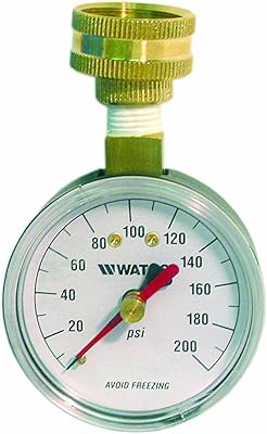

Are you sure you don't have a PRV or backflow prevention device? Even if you don't have one in your house, the meter may (should) have backflow prevention. It's common for water pressure to increase after you go to sleep because a lot of hot water is used before bedtime (showers, dishwashing, etc), then everyone goes to bed and the faucets are not opened to relieve the pressure that builds as your water heater heats up all the cold water that's was drawn into it before bedtime.
Do you have an expansion tank on the cold water pipe supplying your water heater? If not, get a pressure gauge with a high-pressure indicating needle and put it on your water heater drain.
The red needle will stay at the highest pressure indicated by the black needle (you reset it by manually turning the little brass knob). See if the pressure spikes overnight. If it goes significantly higher than your normal pressure (60 psi), then you have something that's preventing backflow and you MUST install an expansion tank.
If you already have an expansion tank, test it to see if it's waterlogged. If it's not waterlogged, test the air charge pressure. It should be pressurized to the same pressure as your normal water pressure (60 psi).
