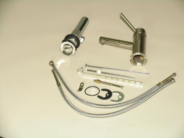

    I have noticed that many companies are using proprietary flexible supply lines on faucets.
    1. Would it be possible to solder in good ol fashioned soft copper tubing stubs into the holes that the flex lines plug into?
    2. I was thinking that if needed the holes could be drilled out a minimal depth with a bit with a diameter just big enough to push a copper tube into and then solder it in.
    Sound do-able?

    Bad, bad idea. Especially if you have to drill out a fitting to accomplish this. Just stick to tried and true compression fittings.

    I should have been more specific.
    I am talking about the main faucet/valve body into which the proprietary flexible lines plug into. The other end of these lines then screw onto the water supply shut-off valves.
    The holes that these lines plug into are the ones I was wondering about soldering copper tubing into. Just like the way faucets used to be.
    Matt B
    --Notice the 2 braided lines with the long, narrow fittings at one end. These fittings go into the bottom of the 'valve body' of the faucet. Notice there are no copper tubing stubs with threaded adapters sticking out from under the faucet valve body - like faucets used to be made.

    Can you tell us a model and brand of a faucet you are talking about. I never seen what you are speaking of.

    The only thing needed might be some plumbers grease on the o-rings. They should engage when pushed firmly in.

    O Rings disintegrate quite rapidly with highly chlorinated water I believe.
    The old system of having soldered-in tubing stubs was very strong and very reliable.
    I need a new kitchen faucet with pull-out spray and I am not thrilled with seeing this new supply hose system on so many faucets.

    Just use the parts they send you.
    Many faucet companies have been using o-rings for years.

    If "O" rings deteriorated rapidly from contact with water, MILLIONS of pipe connections are in trouble. They wear out from movement and those connections do not move once they are installed. You could create many more problems by drilling them out and soldering copper into them, than you would ever prevent by using the supplied fittings.
