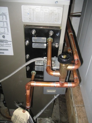

Today at 8 AM I received a call a child was severely scalded, and I had to drive to the accident scene.
3 hours each way very scenic
This happened in Pennsylvania when people were visiting relative's old farmhouse, and the boiler supplies the hot water through coil and they have globe valves to adjust the temperature going into a valve on the H side and one on the C side and supplying a 3/4" copper Y original set up from the 1960's.
When I took the temperature at the shower it was over 178 DEG F
A Local "plumber" was servicing the boiler last week and made some adjustments on the hot and cold water supplying the Y
The thermometer was broken as the dial was pointing to zero
He was able ot test the water by placing his hand in it and adjusted it accordingly according to the uncle of the burn victim
I worked for this same law firm from Pennsylvania when they handled the case in Hunts point the Bronx where two toddlers perished from a steam leak.
I also saw this kind of set up in another law suit I testified against

So.rry. Were the Bronx toddlers unsupervised?
Steam came through the hot water pipe?
What failed here?
Years ago in my little house I.nstalled a Heatmaker™ which created the domestic hot water from a coil inside the hot water reservoir used to heathe baseboard radiators.
