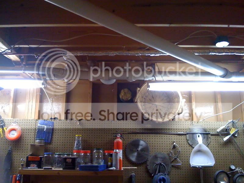

    Here is the tail end of the branch this is connecting too, this shows two drains for kitchen sink and the line to the laundry room and one hell of an awesome clock and light.

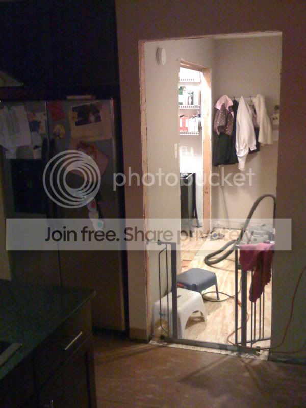

    View from the kitchen of current Pantry (future 1/2 bath)

    Here is HOW i plan on running the plumbing...
    You can see the sink plumbing in the middle, down stream to the right you see the new line tieing into the existing plumbing.

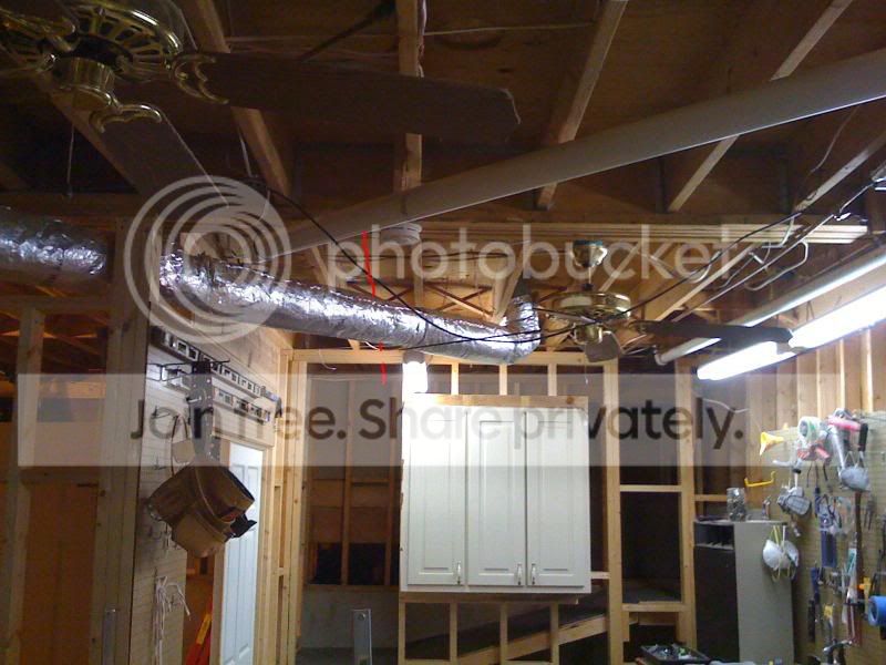

    [​IMG]
    In this photo you see the end of the new branch. The rest of the plumbing needs to go straight back toward the wall (red line).

    Looks like if you turn on that ceiling fan, all hell will break loose!

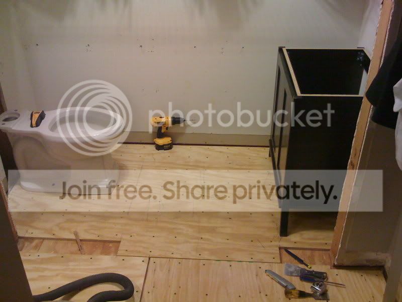

    Is the toilet and vanity sitting in the bathroom for effect right now? There is no reason at this point to have either one of them installed.
    Did you pull a permit for the work that you are doing?
    You have plenty of room to do code compliant work but it will take more than 30 minute clips to get it done. What code is enforced in your municipality so we know what type of advice to offer?

    Just for effect. No pemit. Couldn't tell you what code is
    Enforced, I can call the inspectors and I have in the past and ask, Cherokee county Georgia, what are some of the possible answer?
    Toilet was to be vented with the 2" vent in the diagram.
