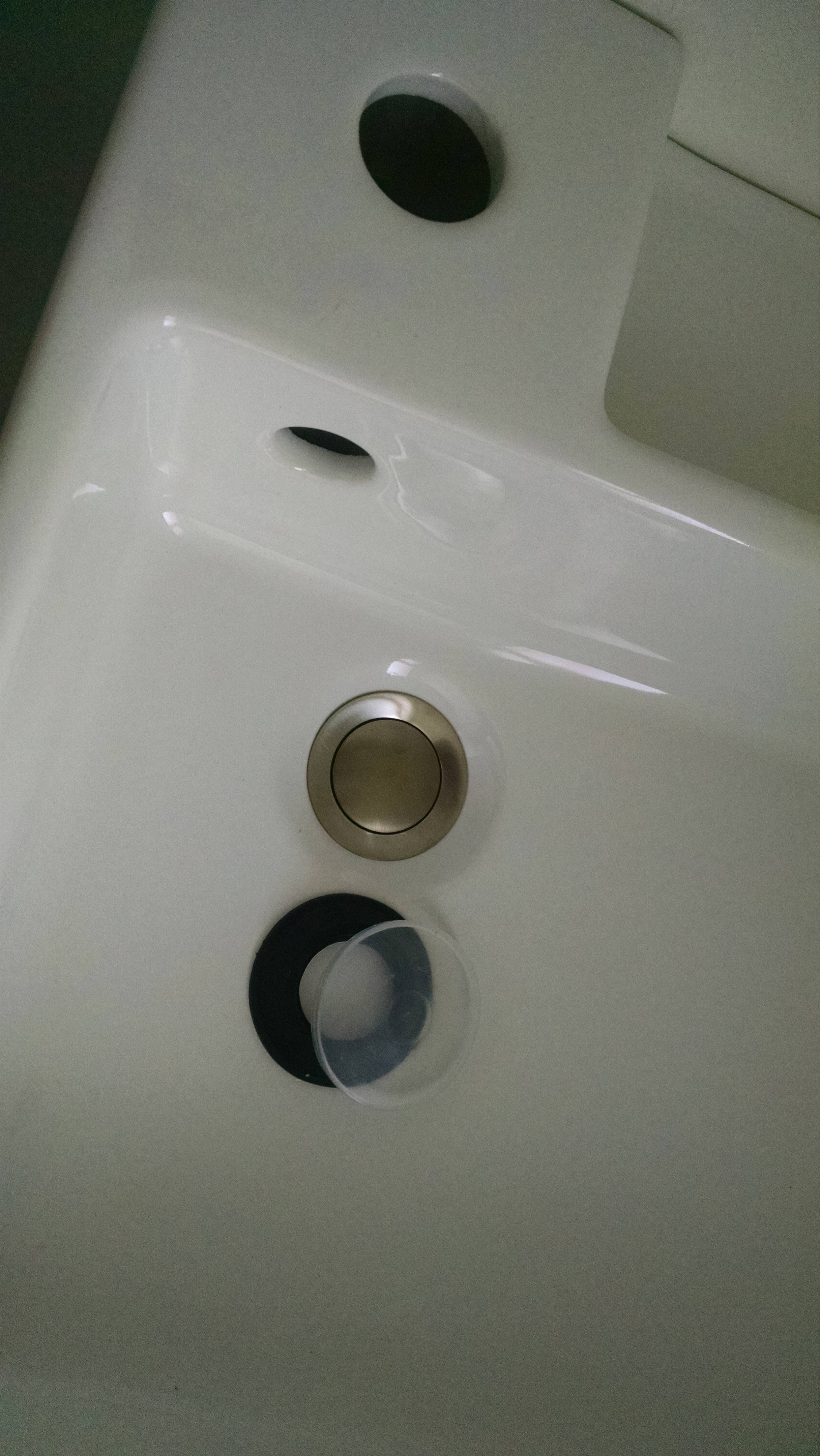

2. Ikea includes a grid strainer and their special space saving drain setup with the sink, but I'd prefer to use the popup from the Hansgrohe. It matches, and I don't really need the extra shelf-room in the cabinet. But, I'm not sure this will work out because it looks as if the hole for the grid strainer is a bit large relative to the drain flange. The flange can still cover the entire hole, but the surface area - surface area is on the small side. Is there a good solution for this? I figured drains were a standardized thing, but I guess not.
What's my best bet?
Am I stuck with the grid strainer?
Do they make a drain flange coupling that can help with that gap?

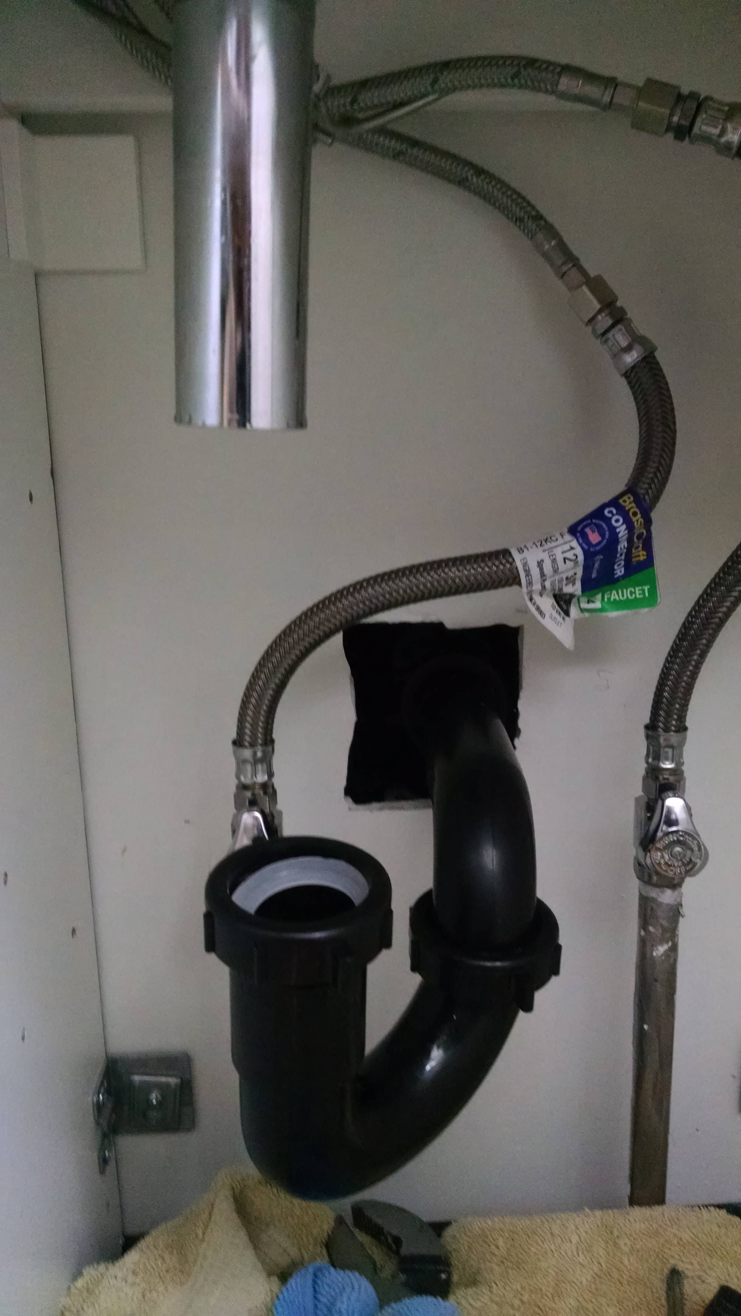

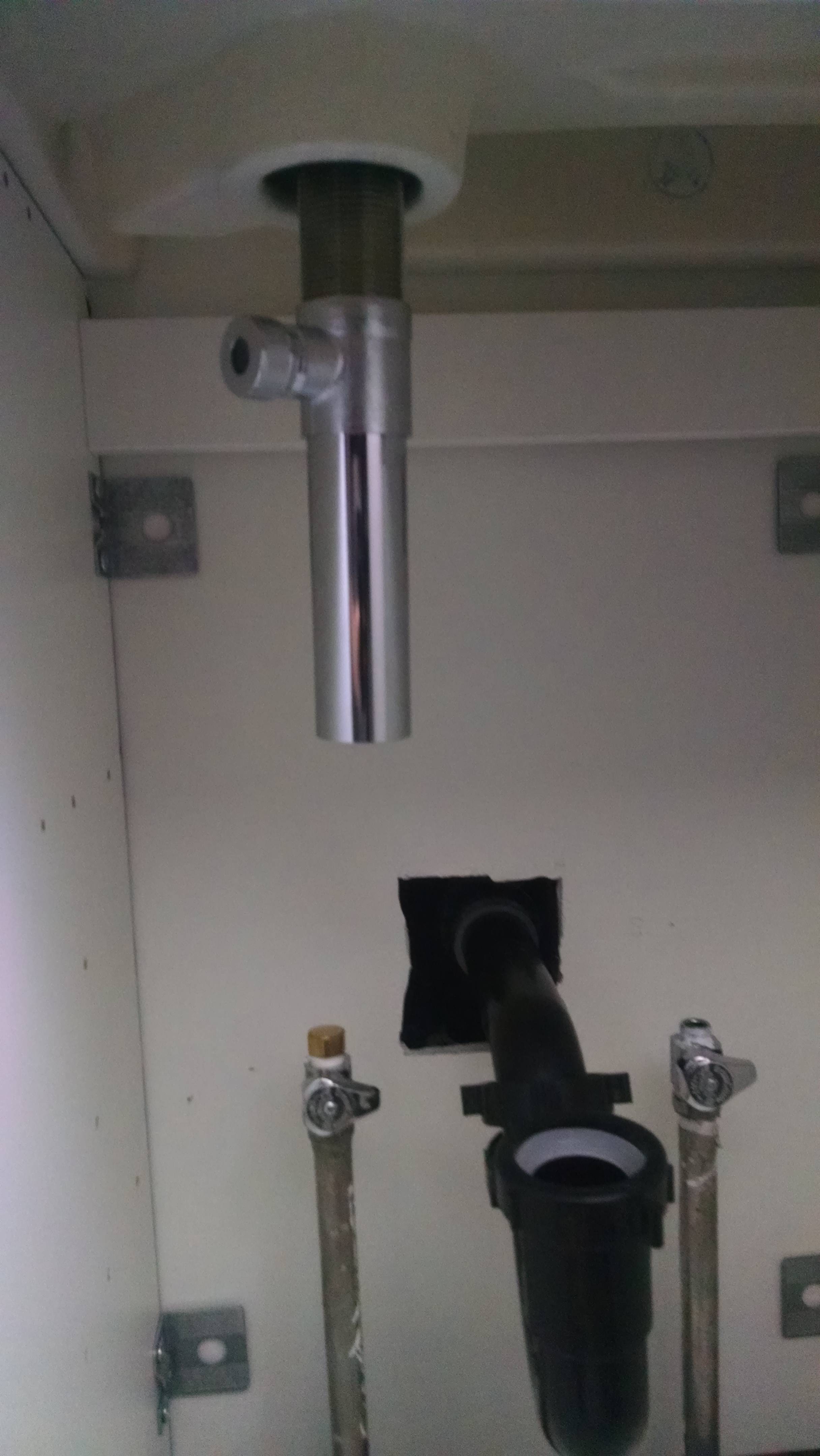

3. The p-trap is sitting pretty low and to the right of the drain tailpiece. I guess I need to somehow get Part A connected to Part B without messing the flow of the water up too much. What's my best move in this regard? I was thinking that two 45s and a straight piece would get me there, but perhaps there is a better way?

The p-trap swivels. I would see if it makes it by swiveling first.
You may need to cut some off where it meets the wall.
From the lav drain, and extension. Or you can pick up a longer threaded tailpiece.

Thanks, Terry. I thought I had enough play to swivel the p-trap when I tried to install it this morning. If I back out the trap arm a lot, and pull things , I can sort of force it into place, but it pulls the drain's seal and there's a leak. It's close, but it seems like the trap is a bit behind the tailpiece and a little to the right, even with swiveling it to the left side.
Here's a photo of what I mean
I went to the home depot to see if they had anything that even looked like it would work, and I didn't see anything that looked viable, but maybe someone out there with more experience would know better.
MrFinPgh
Pennsylvania
sorry - I should have been clearer about that. I took the drain assembly extension off to try and show the offset. The issue is getting the drain extension into the p trap. The p trap is about an inch short from being able to hook up to the drain extension - even with swiveling and adjusting.
3,480
Yes, and you need an extension from the wall too. If you bring the trap out farther from the wall, then the swivel should hit it.
