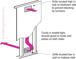

Filtered duct return grilles in common areas need to be at least one square inch per 2 cfm of air handler capacity. So in your case at high speed you're looking at ~1300 cfm, which would need a filtered grille area greater than 1300cfm/2cfm= 650 square inches (bigger is better, especially if you want to keep the noise down). The 8" x 22" in the hall floor is < 176 square inches of free area, the 12" x 24" in the other location is <288 square inches- so best case you're looking at ~450 square inches when you really want 650+.
Door cuts of even 2" (big enough for a kitten to crawl under!) aren't an adequate return for any but the SMALLEST heating & cooling cfm requirements. A 7" round duct has a cross sectional area of about 37 square inches. A 6 inch duct is about 28 square inches. The return paths from individual doored off rooms need to be 1.25-1.5x the cross sectional area of the supply.
At 1 inch clearance from the floor a 32" wide door is at best 32 square inches, 0.22 square feet of cross section, a 30" door 30 square inches, or 0.21 square feet. A relatively modest 4" x 14" supply register over 50 square inches (~0.35 square feet) of free flow area. It might be fed by a 6" duct (~37 square inches), or maybe even an 8" duct (~50 square inches), but you want the return path out of the room to be at LEAST as large (and preferably 1.5x) as the supply register. In rooms where you can feel the air moving through the door cut with your bare hand (not the best method, and well short of a reading with a dual port micro-manometer) it's worth considering using one or two stud bays of a partition wall as a jump duct, with a grill near the floor on one side of the wall, another at the top on the other side:
In new construction stud bay jump ducts would use sealed sheet metal ducts, but in your case that's not possible without ripping open a large section of wall. When using the studs and wall coverings as the duct walls it's important to install well sealed air barriers above the top grille and below the bottom grilles, caulked in place with a high quality long-lasting sealant such as polyurethane caulk. The air barriers don't need to be anything special to work (even corrugated carboard would get you there in a pinch) but using 2x4 blocking would provide a bit of protection against fire spread. Without adding the air barriers using the stud bay as a jump duct introduces new air leakage paths.

YES! Refrigerant charge is the first place to look, once you have verified that the ducts are still all connected. When it's not cooling well enough shortly after installation it's as likely to be overcharged than undercharged. Sadly, there are a lot of installer hacks out there who never calculate or weigh in/out the refrigerant, and never fully commission the system. After visually ruling out gross errors like disconnected ducts improper refrigerant charge moves to the top of the suspect list.
But there are still things worth taking care of on the air side such as jump-duct returns on doored off rooms, verifying that the flex ducts are all stretched reasonably tight (they seem to be in the pictures provided so far), are still connected, and are not collapsed. The flex installation looks about average to slightly better than average in the pictures- definitely not a "ball of mating snakes" so often seen in crummy attic installations.
Getting the room to room pressure differences down with better return paths is important for both efficiency and comfort, since air handler driven infiltration increases both latent and sensible loads. Newer higher SEER units usually need more air flow than an old SEER 10 unit, but even if somewhat restricted should be able to keep up with the sensible load, but might not always keep up with the latent load in a super-leaky house in the Carolinas.
