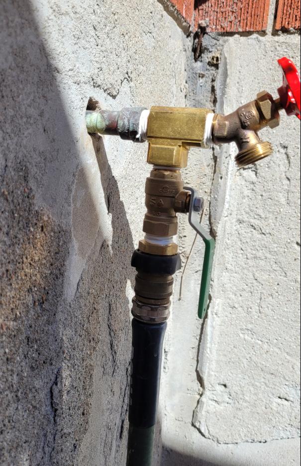

Need to replace a quarter turn ball valve with a full port ball valve to get full pressure outside the house for irrigations

My copper female adapter needed tape so it is not tappered. From what I read the tapperd fittings don't need tape
Incorrect. Your copper female adapter is tapered. Connections between a tapered male and tapered female always need a thread sealant, which can be teflon tape, pipe dope, or both.
You misread or read something that was wrong.

MIP = male NPT

While the suggestions you have so far received are correct, there will continue to be bottlenecks regardless of what you do outside.
You are installing an irrigation system that is designed with a 3/4" diameter mainline, which is being supplied by 1/2" piping. Perhaps it will not require a 3/4" supply, but that will depend on how many emitters are to operate at the same time, and the flow rate needed for each.
In addition, since we can't see on the other side of your foundation wall, for all any of us know, there maybe a section of 1/2" PEX line feeding the copper exterior faucet stub, and the interior isolation valve may not be a full bore ball valve but may instead be a 1/2" globe valve that will also be restricting the flow rate.
Although 90 psi static pressure will assist to increase the flow rate through the 1/2" supply line, that pressure is too high for a residential application. City of Toronto typically supply ~60 psi through the municipal system, so assuming your gauge is accurate, this leads me to suspect you are utilizing an alternate water source such as a private well?
Since the supply pressure for residential applications should not exceed 80 psi, perhaps your well pump pressure switch setting is too high or, if water is from another source, your Pressure Regulating Valve maybe set too high or is not regulating pressure properly.

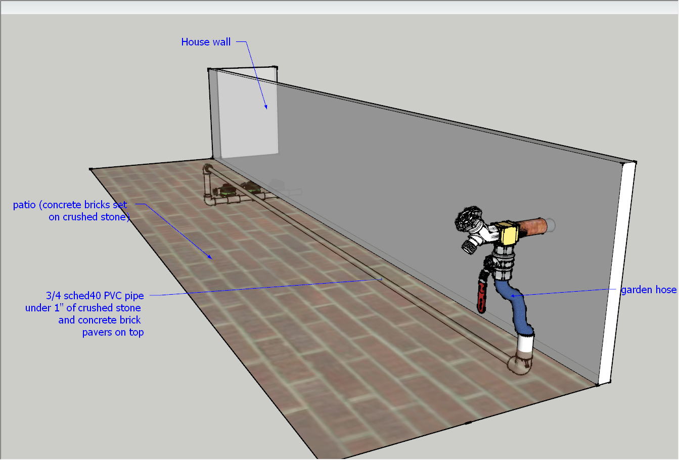

NO WHERE in your drawings do I see the REQUIRED ant siphon/backflow preventer. And I hope you ralize that that "valve" is actually a "frost proof" hose faucet which has an integral back siphonage device, NOT a "valve".

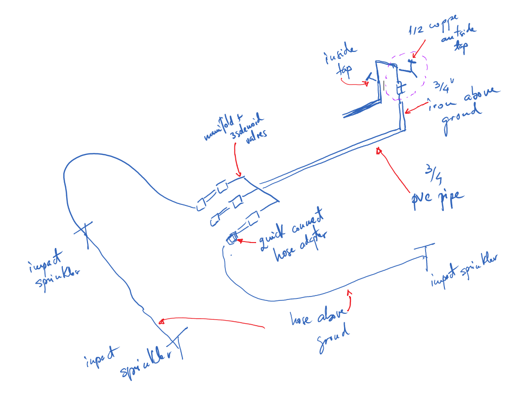

Tthe 3/4" requirement for the PVC pipe line that feeds the irrigation system is based on what is easily available here in the store
Here you can see the initial irrigation design/plan .
However I decided to simplify that to the minimum and use a mix between the in ground and above the ground irrigation system with the plan to upgrade that later to full underground.
Here is a sketch of the new temporary design
With the plumbing design discussed here in this thread (area circled with purple) I thought I would have 3/4" all the way to the manifold.
The plan was to I use impact sprinklers which I do not mind leaving permanently there if I can quick connect them to an underground pipe. With these I could easily cover the two sections of the garden that I need to cover. (see the plans in the link to the irrigation thread).
Considering the needs I could easily cover the areas with impact sprinklers or with oscillating sprinklers
The idea is to permanently build the segment from the water tap to the manifold and from there to test using an old hose that I can cut and use the segments to connect the sprinklers and the manifold quick connect ends. I can test and relocate the sprinklers as I wish, daisy chain them if the pressure allows me to do that and size the system as I go through this experiment.
I think there is still value in building the system as guided in this thread (thanks a lot guys!!) and then later replace that inside valve which is 1/2 most probably and it is a regular valve (one of those with circular handle).
I think I did mentioned somewhere that I plan to buy install these but they are not represented in the drawings, see the posts that have Sketchup drawing attached

OK I decided to replace the Iron Pipe that was sticking out of the ground with a garden hose that I will remove at the end of the season. I will use that end to also connect an air compressor to winterize the system.
I decided not to use iron pipe there for two reasons:
-the thread was tapered and it was not going to work well with the straight thread presented by the PVC elbow
-I also needed the point where the PCV pipes exit the ground to be as close as possible to the wall, doing that with iron pipe would have required more fittings
Do you see any problem with this setup ?
I will add a vacuum breaker/backflow preventer upstream of each point where I connect a hose
