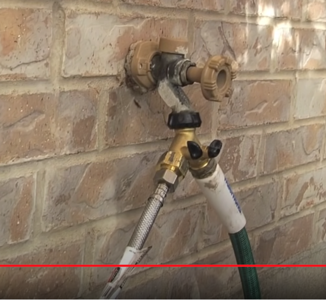

I need to implement the below. (seen in this video https://www.youtube.com/watch?v=5_K-xQHi6L0&ab_channel=iScaper1)
the left side goes to that 1/2" brided connector and from there to a metal pipe which connects to the 3/4" underground white PVC

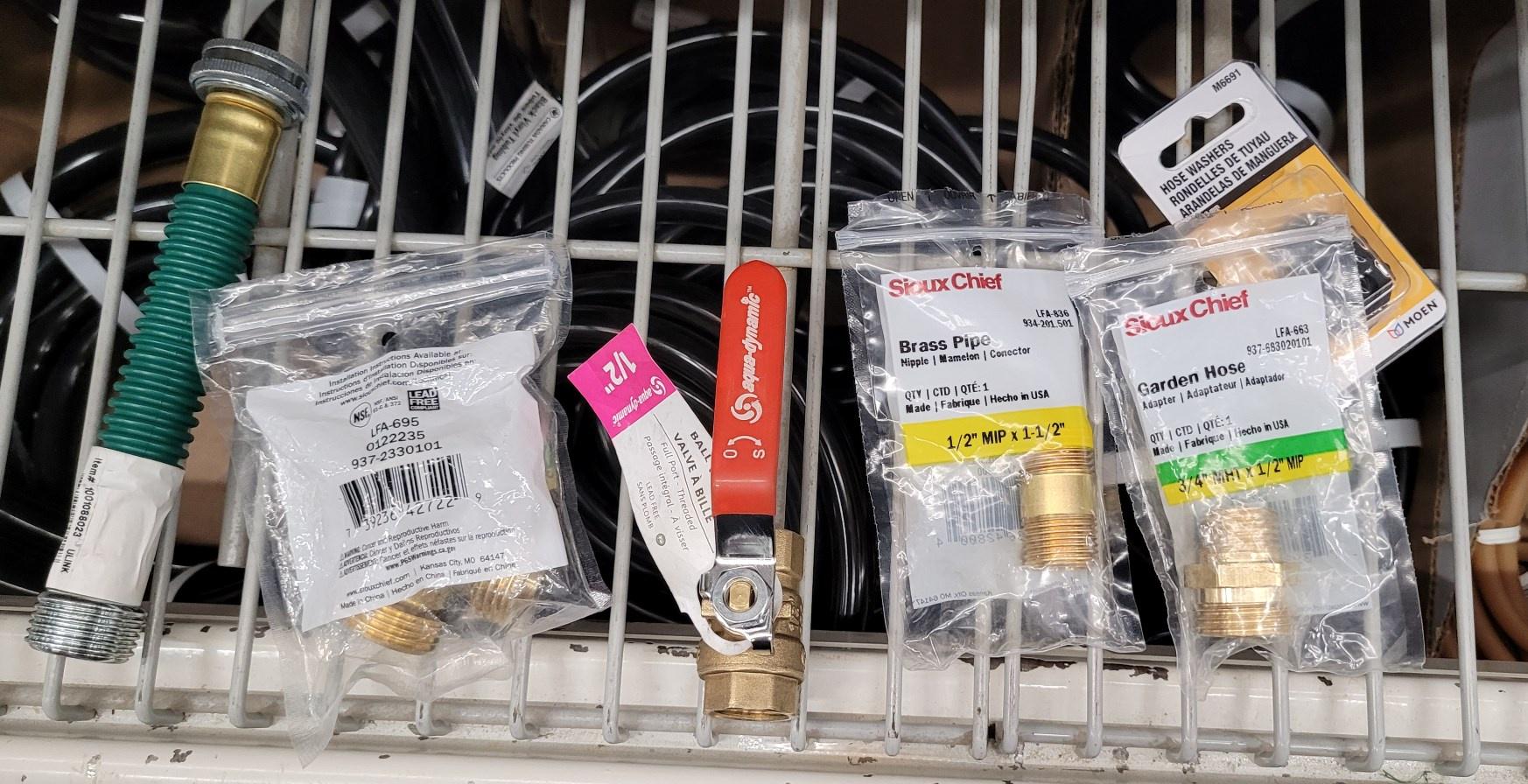

I went to Home Depot and showed the guys what I wanted to do. Here are the components of the solution, ignore the small green hose in the picture.
These are full 1/2" all the way to the hose

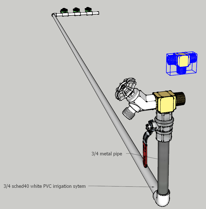

I need to transition from 3/4 hose adapter to the 3/4 metal pipe that sticks out of the ground (metal because it is exposed)
I am trying to implement what is in this video but without the brided connector that would be a bottle neck now
I think I also need a solution to direct the splitter vertically down as all this monstrosity will be sticking out of the wall way too far and big

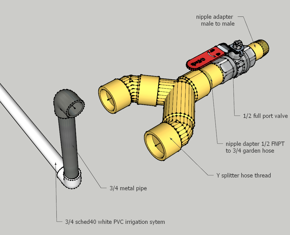

Here is a drawing with how fort I could go with this

So get a brass (lead free) 1/2" street tee and thread the male end (with thread sealant and two wrenches) into your 1/2" female copper adapter, with the side opening pointing towards your irrigation hookup Then get a 1/2" MIP hose bib of your liking, with a built-in vacuum breaker. That goes into the straight inlet on the tee. And a 1/2" MIP x 1/2" FIP full port ball valve goes into the side opening on the tee, and then you connect the 1/2" FIP outlet to your irrigation system, which needs an appropriate backflow preventer

So you are suggesting to use a fitting like the one highlighted below. (vacuum breaker and backflow preventers not represented)
The problem is that I can't find one that is MIP everything I can find with the name street tee is NPT, and mostly 1 male 2 female like this one
