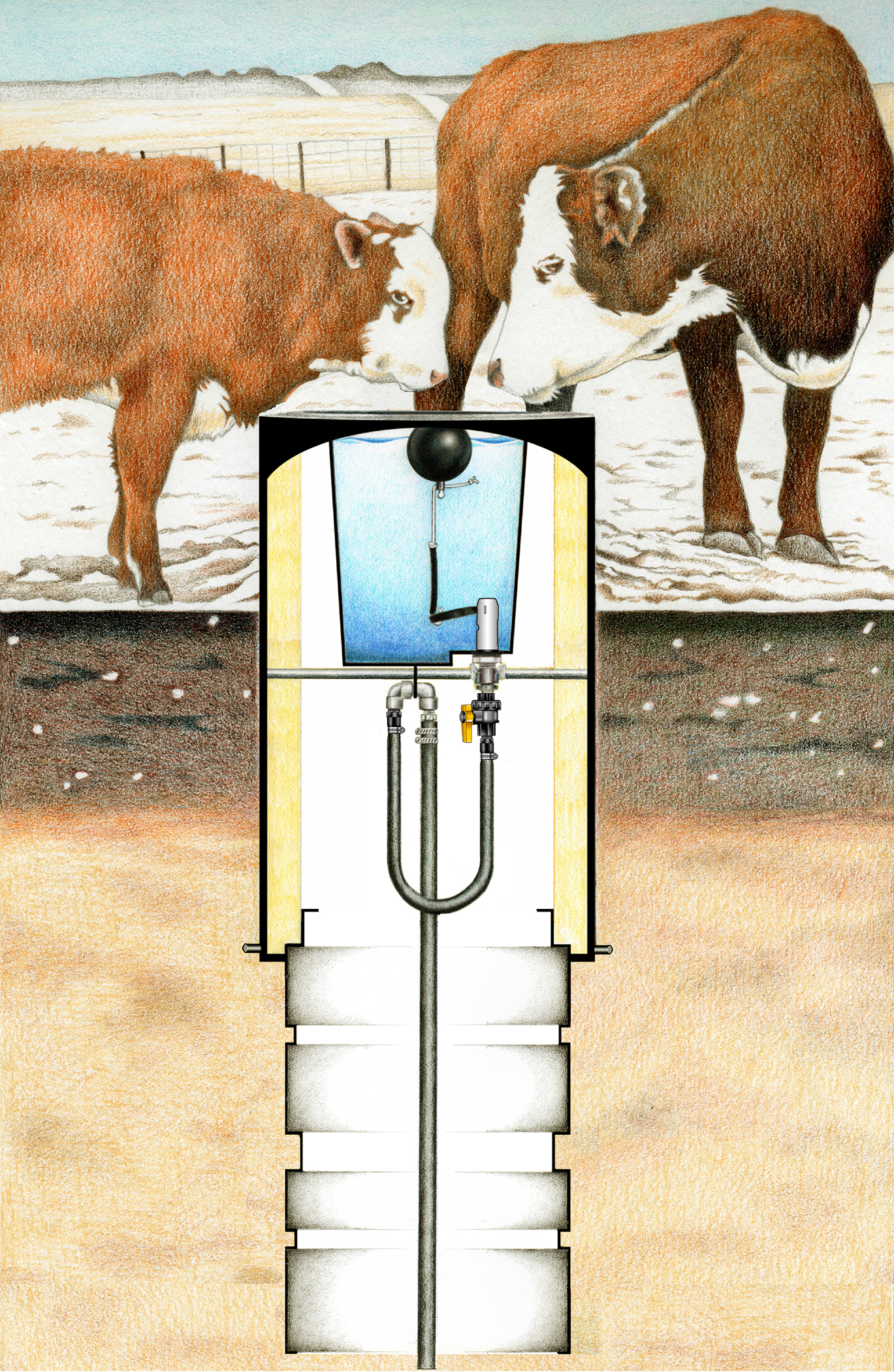

I'm not the only person running livestock in a freezing climate. There are a multitude of solutions to this problem. Valveman alluded to 1 solution but I'm not blessed with abundant ground water so I can't do that (leave the water run). In my case I'm using a Cobett freeze resistant waterer. It is insulated with 4" closed cell foam and it gets buried 8 ft in the ground to take advantage of the thermal mass of the ground (there is a big hollow chamber underneath where air, heated by the ground rises and heats the trough of water).
