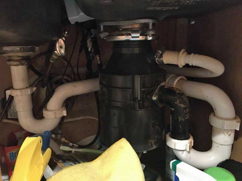

This is the way my under sink looks now. I'm really struggling with how to clean it up. The stub out is to the far right of the cabinet. I feel like this would be a lot cleaner if I moved the disposal to the other sink. That would allow me to put the trap under the right sink and just pipe the disposal straight over like the way preferred here. It seems like most people prefer it in the smaller bowl, but that doesn't really matter to me.
I want to make the stub out lower which will hopefully allow me to use only one trap.
A big problem I'm having right now is how crowded the space behind/between the two sink bowls is. I have a touchless faucet with a giant valve brick up in there. Sometimes the sprayer hose gets stuck. I don't even have enough room to get the weight on the hose.
(When I do this, I'll also be replacing the inlet valves and wiring the disposal on an outlet and cord to eliminate exposed Romex.)

OK.. so if you're going to make changes to the water lines too, you have the perfect opportunity to fix that space to make it work for all the extra stuff we have going on in a modern kitchen sink cabinet.
I like to have my water lines stub out on one side of my sink cab opposite the side of the disposer. H&C dedicated for the faucet and separate water lines for each other water fixture.. IE hot to the DW and separate lines for insta hots or filters. You can buy disposer continous waste kits that pipe straight horizontal out of the disposer to the side of the tee.. then bring the other sink bay to the top of the waste tee. You can aim the disposer and sink both back to the trap that is out of the way
The smaller bowl is intended allow the output/discharge of the disposal to be higher than the trap adapter at the wall. You must be going lower on the way to the wall.
A self-leveling laser level can help you see the levels. Yes, you can use a bubble level, but the self-leveling laser level makes it much easier.

I didn't catch the multiple height bowls. But by lowering the stub out you can combine both sink bays to drop into one trap as they're intended to be done.

The infrastructure is done. Still have to finish plumbing under the sink, but I bought the wrong size shut off valves. (Need 3/8, bought 1/2.)
I made a few mistakes in the glue up order that made my life a lot harder. Almost lost my whole trap adapter assembly due to a bad joint but managed to pull it apart and salvage it. Oh, and I only broke one drill bit drilling out the lead and only wrecked one sawzall blade.
The bad flex duct run is from a lazy subcontractor and will be fixed eventually. Slowly working on fixing up the ductwork, but it's like pulling a thread. For everything I fix, I discover 5 things that were hiding.
I'll cover my ugly cutout with some lauan.

Does the extra "trap" in the dishwasher hose between the high loop and the garbage disposal matter? I thought that the dishwasher hose should be strictly downhill from the high loop to the disposal, but maybe I'm mistaken.
Cheers, Wayne
3,482
Cheers, Wayne
I forgot to look at that, I was focusing on the p-trap. It's best to run the drain from the dishwasher high first and then grade downward to the disposer. Yes :)
