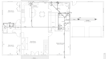

Hey guys,
I have a new build coming up as a D.I.Y 'er and would like some valuable insight,
this is a floor plan for a 1 story home including a loft,
well,
this situation might be a little different...
on the first level I have all bedrooms and plumbing fixtures,
I really want to ask if the way I plan on venting is legit...the left side of the home represents a basic bathroom shower, toilet, and Lav,
the right shows the same with a few extra fixtures... my thinking was I can't chew out my foundation nor want to do that I believe I have more than enough space.
I want to know if I could use a sanitary tee and elbow to branch off/ or a wye and 45 take off for vent lines taking off under the slab as this would/might be considered circuit vent?? any thoughts would be appreciated... also every fixture on the right side of the home will be connected like this vent line as you see my foundation is pretty much telling the story thank you.

Breplum
Licensed plumbing contractor
2,588
1,110
San Francisco Bay Area
For slab plumbing I say you should always hire a licensed professional plumbing contractor. There are so many wrong ways to do things, we can't teach it all from one-liners.
I have been called in to countless DIY slabs right before the pour and had to spend days redoing to meet code, better-support with correct compaction, prevent movement, isolate with proper penetration protection.
Save yourself a lot of grief at least for the under slab.

thanks for clarifying,
However this superior wall foundation is already layed out, mostly all the venting for the fixtures will be underground branching off the drain line, is it possible to use a sanitary tee on its back and the vent line will be branching off of that connecting to other fixture vents?? Kinda like what’s seen in the picture?? I’ve read somewhere in the 2018 ipc that there are exceptions to the rule regarding venting being below the flood level rim in certain situations, I believe my foundation calls for that exception what do you guys think?

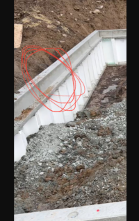

It’s not the left side of the home I’m worried about, it’s the right side, I can do the venting thru the walls on the left side because that is an interior wall it will be in, however on the right ride I have marked where the vent lines are an my foundation will not allow me to start chipping away at my concrete walls as that will be where my exterior walls will be placed supporting the building, I have had these plans drawn up, I kind of like the idea of running the drainage and branching off of them either by a 45 takeoff or using a sanitary tee on the drain line with the vent pipe over top of that all of these fixtures connect eventually and go out of a main stack again in an interior wall I can’t do exterior because that is where my sill plate will be, is it possible to run these vent lines underslab and connect to a vertical stack?
Thank you for all your help.

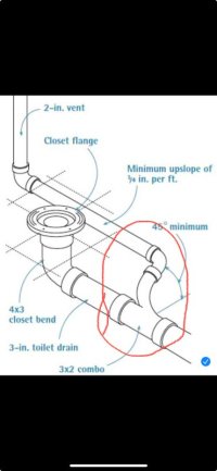

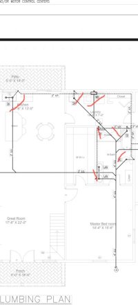

I tried to show a sanitary tee branching off the fixtures connecting to a vent line if this makes it better and they all connect to a main vent stack going in a interior wall and thru the roof
41,408
4,996
Can you have the right-hand lav, shower and tub drains on a higher plane than the laundry drain? That would make wet-venting that bathroom plumbing easy. Dry-vent the lav, and the shower, tub, and toilet get wet-vented.
I don't know how the garage drains fit. Are they considered emergency floor drains and can join the bathroom group? I don't know. I am not a plumber.

I’m glad you understand my question, unfortunately, all fixtures are on the same floor as far as I can tell every fixture on the right including the kitchen sink will be dry vented, I have the idea in my head that I could branch off every fixture with a sanitary tee or wye and 45 takeoff and just run the vent line to the next fixture and so on what a breeze that will be instead of chipping away at the concrete to get pipes in the wall, again the good thing is everything will be dry vented meaning the vent pipe will be at a 90 degree angle over top of the drain pipe it will look something like this

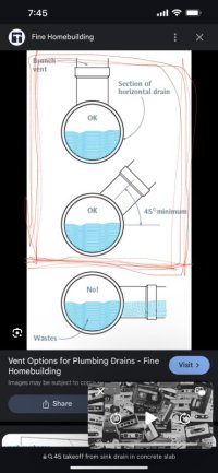

Which represents the current state of the project, the 2nd picture in the OP, or the 3rd picture in the last post (post #11)?
As to your last post, pictures #1 and #3 are not correct. A vent may not turn horizontal below the flood rim of the fixture. That diagram is from an older book that is out of date. And if picture #3 is what you already have, it needs to change.

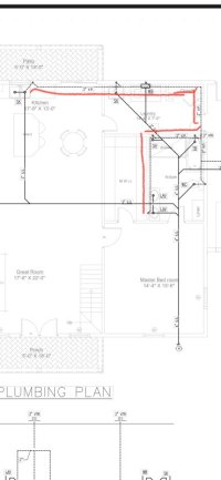

Why? What is mandating that choice? Or are you already at the point where most of the below floor pipe has been installed?
If you still have a blank slate, I could mark up your floor plan with a way to run the DWV. A clean floor plan with the fixtures but no drains shown would be the best starting point.

I am not going to think much about your latest post, since it did not click in my head on the first try, but I will point out that your IMG_5730.jpeg AND your IMG_5787.jpeg both illustrate enough vertical space for pipes to cross over each other.

Those are just pictures that gave me an idea of using a sanitary tee off a drain line for fixtures but the floor plan is mine, again there is no way that I can chew away at the exterior of the foundation for a pipe hence why I wanted to run the vent pipes off the the drain lines coming from the fixtures I am well aware that the vents need to come up 6 inches above the flood level rim for a fixture however I also know there are exceptions to this rule especially dealing with a foundation so ultimately thinking I can branch off the drain lines with a tee fitting and connect the vent on top the floor plan tells the whole story, every fixture on the right will be dry vented meaning all vent pipes will be over top of drainage using a Santee on its back or wye and 45’s if you could I’m curious as to another way I could run the vents but it would have to be in a interior wall
Herbie123
28
Factoryville pa
My apologies, yes I have a superior wall foundation that is going to be for a slab this is not a poured foundation pretty much my foundation is mandating the choice as it’s designed for the walls exterior walls to sit on them I cannot and repeat Cannot drill holes for pipes where the wall sits I’m getting ready to do rough in plumbing next week or so if I can I’ll try to upload another picture of the foundation for better reference thank
You.
Herbie123
28
Factoryville pa
If you can see the top part is solid that will be the lip the walls will sit on no holes can go thru that

So you aren't wedded to the idea of dry venting every fixture? Wet venting is OK?
Cheers, Wayne

No in reality these will be dry vented it’s hard to explain when your not right in front of it but obviously the drain pipe will be alittle lower than the vent pipe, the drain pipe will be branched off and the vent pipe will sit on top of that again which will look something like this every fixture on that right side can be done like this including the kitchen sink and toilet.
wwhitney
7,259
2,072
Berkeley, CA
Dry venting versus wet venting is a design choice; both are allowed by the plumbing code. You can dry vent every fixture but it will make your install harder/more complicated, particularly near those basement walls you can't modify.
So again, is there a reason that you require a design that uses only dry venting?
Also, to double check, this will be over a full basement, not a slab on grade, and you are in PA, so the IPC is your plumbing code?
