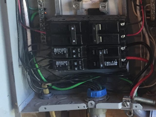

Just bought a extra fridge and wanna use it in basement. So, I have to make a new circuit for it. Because we already have a fridge on my kitchen which served by No 16 breaker .( see my main board )
No 16 : 15A squire D breaker, type QO
My question is : I don't have space to add extra breaker for the new fridge, can I make a Parallel plug circuit with the previous fridge circuit?
run 14/2 wire , connect the hot line to No 16 breaker . I see the pole can accommodate 2 wire , but not sure
any suggestion can help me to avoid add a sub box for it? I am amateur , dont want to do complex things.
thank you !

It looks like you have one full sized and one half-sized slots left in the panel. If you look at the panel cover, you should see that those spots have nubs on them. You can grab a pair of pliers, twist it back and forth a bit and it will break off leaving you room to then install a new breaker.
A typical refrigerator can pull a bit more than what it takes once it's running. Trying to power two of them off of the same breaker is just asking for the breaker to trip.
Being in a basement, today's code wants the receptacle to be at a minimum of a GFCI, but many places are also calling for an AFCI. You can get that in one breaker if you want. This may not apply in Canada, but a GFCI is still a good idea. Some will disagree, as if it trips, and you don't recognize it, you might then lose everything in there...but, not having the protection if there's a fault, it could kill you. A properly operating unit will not trip a gfci. If it does, there's a problem.
Depending on how the basement is finished, you may need to run the wire through a conduit to protect it.

THANK YOU sir, and I checked my panel , it looks like no slot for new breaker. the picture is below , do I need to
buy a sub panel for it? really do not want to do so, it will cost extra money and time.

Why do you need to wire? Are your basement circuits overloaded?
At least in the US it is against code to use a kitchen circuit for a basement receptacle.

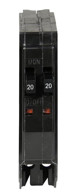

This may not apply to Canada but here you need to look at the label to see if your panel was supposed to take tandem breakers. Yours also appears to have only enough neutrals for the 24 spaces. Regular tandems won't physically fit. The cheater tandems (non CTL) are a lot more expensive if you can get them.

Before doing all that work, why not plug into an existing outlet on a basement circuit, ideally one that doesn't see a lot of use and is on a 20A breaker. If you plug in a tool or something and trip the breaker, you'll know and reset if before the food spoils.
A subpanel might be an option, as is using the half breakers if the panel allows you to add more. However, I think plugging in somewhere could be a good bet.

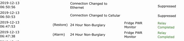

Having a refrigerator sharing a GFCI could cost you spoiled food if you get a nuisance trip and didn’t realize it
I have an additional refrigerator in my garage on a shared 20 amp GFCI circuit. In the past the GFCI has nuisance tripped without us knowing, so I rigged a power monitor connected to my home alarm system. I immediately get a text any time the power goes out and another text when power is restored. I have that alarm zone configured as a monitor only zone so the central station doesn’t call me.
You can see from alarm log below the last time that power was out. It was out for 15 seconds and then restored.
You can also see internet went down and alarm switched to cellular communicator then it switched back to internet communication.

You should probably give up and put in the subpanel. Making a mod to let you use a tandem breaker would probably not go over with the inspector. Yours is an old panel probably not approved for the tandem breakers.
