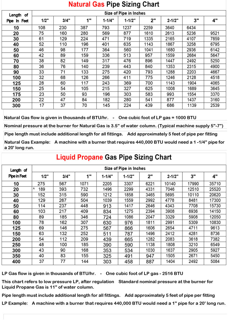

That's probably 7" water column (W.C.) or about 0.25 psi, which is a typical low pressure residential distribution pressure inside the house. I have no idea what units of "7 C.U. " would mean.
Even though the connections to the Rinnai are 3/4", it is going to need a substantially larger dedicated run of something bigger. It is better if the line isn't shared by branches off to other appliances to have trouble-free operation, even if the gas plumbing is sized to handle both loads. Most houses need a dedicated 1-1/4" gas line between the meter and tankless to support a 180KBTU modulating burner reliably. Modulating burners are more easily disrupted by the sudden blips in pressure as other burners come on/off than dumb on/off burner.
The chart below is in 1000s of BTU, suitable for 5-7" w.c. supply pressures out of the meter. Be sure to add in the "equivalent feet" for every ell, tee and valve on the path. Also see the chart on p46 of the installation manual.
The other thing you need to check is whether the meter is big enough to handle the upsized burner. A 120K furnace + 180K water heater + ??K cooking appliance is probably north of 400KBTU/hr, and a lot of residential gas meters are under 300K. When going from a 40K tank to a 180K tankless it adds 140K of max load onto the meter.
The "central heater" with a 120K burner is obscenely oversized for the actual space heating load of most homes in San Jose. It might more sense to replace it with something right-sized for the load- maybe with a hydro-air air handler running off the Rinnai, if it's a hot-air furnace. If the same ducts are used for both heating and cooling it could mean replacing the air conditioner too- there isn't enough info in the post here to make the call as to what the "right" thing to do is here. But a 120KBTU/80% efficiency furnace is enough heater to theoretically keep my 2400' sub-code 1920s bungalow + 1600' of conditioned basement comfortable at an outdoor temperature of about -100F. (A hundred below zero.)
Ridiculous oversizing factors makes recovery from overnight setbacks quick, but it's the opposite of "comfort". ASHRAE recommends an oversize factor of 1.4x the load at the 99% outside design temperature. In San Jose the 99% design temp is +37F, a temperature at which the load on my house would be about 18-19,000 BTU/hr, so if I were in your neighborhood the biggest heater I'd need per ASHRAE is 19,000 x 1.4= 26,600 BTU/hr (output), which could be a 30,000 BTU/hr condensing gas furnace or a 2-ton heat pump, or a 2 ton hydro air handler on a condensing Rinnai.
We can go further down this side track if you like, but you have some homework to do before picking a Rinnai on both the gas plumbing and gas meter end before dealing with the venting issues.
