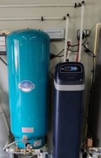

With odor you may be looking at tannins and organics present in your water, the organic matter or iron that is present at 1.02ppm could be causing the discoloration. With coliform present I would be most concerned with that, making sure you properly treat the bacteria. I would recommend doing ozonating over UV treatment if maintenance is something that you are concerned with. I went with an EcoWater ERR3700 which treats hardness and iron https://ecowaterspokane.com/water-softener ERR3700
and
Microzone CD550 (see my installation below) https://www.cwtozone.com/products/water-purification-products/micro-series/microzone-cd550/ Microzone CD550
I also went with a HERO385 reverse osmosis as a final polish for point source to ensure the water for cooking and drinking is the best possible.
Maintenance with my setup is 1 bag of salt per 3 months for family of 4, 3 bed 2 bath, pre and post filter on RO every 1 year replacement and membrane every 3-5 years, I know people don't want to spend time and money on salt, and with the system I went with the efficiency is phenomenal literally filling up my brine tank with 4 bags once a year is a nice exercise :)
