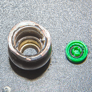

I took the head apart and found no serious limescale. I did discover a hard and possibly swollen o-ring in the flow restrictor. The resistor has a central jet and a set of jets around the perimeter. The perimeter jets seemed blocked by the o-ring. I tested without the flow restrictor and the flow was way too much. So I replaced the o-ring and it's working well now. Unfortunately for me I did a lot of work to find an o-ring was the problem.

Thanks for the info. Was the O-ring in a restrictor like the green one in this picture?

Not exactly the same, but a similar design. I'm not sure what the o-ring is supposed to do (partially block the perimeter or check valve?) or the exact OEM size, but swelling of this over time would explain my gradual loss of flow.
