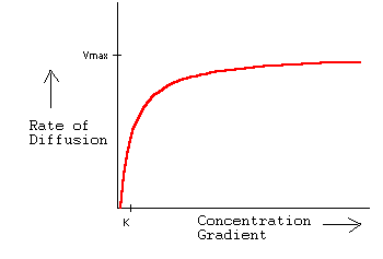

Let me offer the way I envision it.
If you want to purify ethanol, it becomes harder to get from 95% pure to 96% pure than to 95% from 94% pure.
If you want to diffuse thru a membrane you might get a graph such as this:
from https://legacy.nimbios.org//~gross/bioed/webmodules/diffusion.htm
So some processes get less speedy as you approach a limit.
As I picture it, the Ca/Mg ion replacement gets harder as you get closer to the limit.
In my mental model, the more efficient salt settings do not cause the resin to get regenerated to full capacity during each regen, but to instead get regenerated to an intermediate capacity during each regen. So I expect the residual hardness the day after regen to be higher if using a leaner brine setting. But this leaner brining does clearly let your get more hardness removal with each pound of salt.
You might find some interesting material in http://media.wattswater.com/F-WQ-EngineeringGuide.pdf But that information is not derived from first principles. Still, it is a nice more comprehensive write-up. A lot of practical softening procedure is based on having been adjusted for being easier to implement. That Watts manual is 40 pages, and I expect it has been considerably condensed itself.
It does not much matter if the model is correct if it has useful predictive power. “all models are wrong, but some are useful“
I have no heuristic model for why "Brine concentration should be between 8-15% NaCl (or 30-57% salometer) upon introduction to the softener for a downflow brining system." I am willing to appreciate that those who designed the injectors caused the mix to be in the efficient range.
