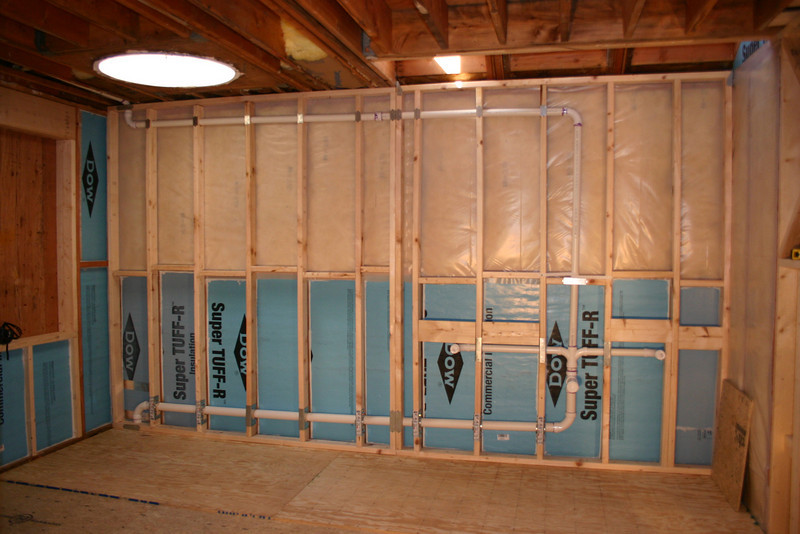

Im finally ready to hook my enclosed double vanity up.
i have attached a diagram
A is a 90 deg hubxhub TY
B is a long 90 deg elbow
C is a sanitee (can also be swapped with a A?)
most black lines are studs., 2x4's
red is existing drain
blue is vent (blue attached to red/c which goes all the way up was existing)
the vanity is a fully enclosed double vaniy, and each section under the sink is seperated by a wall (cabinets/storage) so the drains need to connect in wall..
I did search and see that another way i could have set this up was if i used a 4-way sanitee in the middle, branched left and right for the drains and simpy gone down and then left to hook to the drain... and vent would have been up and left... But i couldnt drill holes low enough, some sort of steel reinforcement? anyway.,
will the attached work? am i using the right connectors? i made sure i got the long 90's for proper flow and venting
