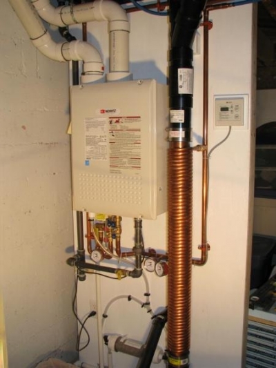

It's possible that the dip tube on your water heater is corroding away, giving the water heater a lower "apparent capacity".
Unless you have competent electrician & pluming skills, it will cost more to install the dedicated power wiring & breaker installation for the than the $300 for the TankBuddy itself. You're probably looking at about a grand all-in to have it professionally installed, possibly more (do you have sufficient space in the breaker panel? Does the wiring need to go through finished walls/ceilings?)
If it's showering performance you're after (rather than tub-filling), putting the grand toward a drainwater heat exchanger would be better than up-sizing the tank or adding a TankBuddy. A drainwater heat exchanger doesn't use more power, but can recover ~50% or more of the heat that's literally going down the drain, returning it to the incoming stream of cold water prior to the water heater & shower, roughly doubling the showering time for a 40 gallon electric tank with a 130-140F storage tank, and turning a typical 40 gallon gas burner into a "never ending shower" experience at a 2 gpm or slower flow.
With plastic drain pipe it's a pretty easy DIY. The fattest and tallest that fits is the "right" one, since the additional marginal cost is small compared to the additional recovery efficiency. The ~50% return efficiency starts at 3" x 60" or 4" x 48", but if have more head room to work with, taller is better.
It won't do a thing for tub-filling capacity, since the heat recovery can only take place if the drain is flowing at the same time as the water is being drawn.

Wow, an 70's vintage trombe wall house- I remember those! (Got any pictures to share? Do document the mechanicals before gutting that room!) Hopefully they put an insulated curtain wall between the glass and the vinyl siding! I'm very curious as to how the finned air-to-water pre-heater was supposed to work- could it actually by a water-to-air hydronic coil taking stored solar heat from a tank for space heating purposes?
Gravity film type drainwater heat exchangers have been around since the early to mid 1980s, but had/have a low net-present-value if installed solely for the energy savings in low energy price markets. At NY electricity pricing the financial payback is quite reasonable if heating hot water with electricity. The showering-capacity performance has a different payback since it can also reduce the size & cost of the other mechanical systems up front.
National Resources Canada has established a test protocol to be able to compare apples-to-apples on the return efficiency of different makes & models, independently tested by third parties (not just the manufacturers.) A downloadable spreadsheet for making those comparisons lives here. Most vendors will sell them at retail pricing from their websites, but they can also be ordered from the big orange box store. Renewability often has a discount priced unit (the model varies) up on Amazon.

Plumbed correctly a drainwater heat exchanger helps all the time during a shower, not just at the end, giving the tank an "apparent capacity" boost.
The heat exchanger should be plumbed to feed it's room-temperature or higher potable water to both the cold side of the shower AND the hot water heater. The shower's mixer then uses hot water out of the tank at a slower rate, since it's mixing the 125-130F or whatever hot water with 70-75F water rather than 35-45F water to come up with a ~105F shower head temp. Additionally, the water in the tank is being diluted with room temperature water rather than truly cold water, thus taking longer to drop to an unacceptable showering temperature.
Even when the tank's temp has dropped to the tepid 90sF at the output, the recovery time is much quicker than if the tank had been fed cold water rather than pre-heated water dropping to the 90s at the top, since the bottom of the tank is ~70F instead of ~40F.
A typical 2 gpm shower with a 70F rise (35F up to 105F) is a heat rate of ~70,000 BTU/hr, or ~20,000 watts. If half the heat is recovered from the drain (again, a 4" x 48" or 3" x 60" or taller) it's only pulling heat out of the water heater at 35,000 BTU/hr, or ~10,000 watts. A typical 40 gallon electric hot water heater delivers 4500 watts, so without the drainwater heat exchanger the shortfall is a whopping 15,500 watts, with no chance of keeping up and with a sharp rate of temperature decline. WITH the heat exchanger the shortfall is about 5500 watts- the average temp in the tank is dropping at only about 1/3 the rate.
