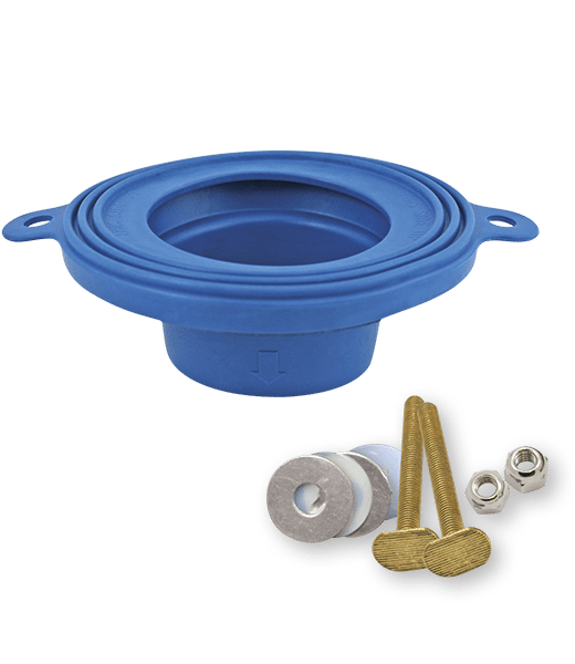

Hello,
I live out in rural Texas and its hard to get a plumber to come where I live. I have a house that is on a hillside with all 3 toilets on the top floor that extends down to a dirt cellar. House is only 5 years old. Just bought it a year ago.
I discovered that one of my toilets was leaking severely underneath, so I removed the tank and bowl. I discovered that the wax seal was not properly installed. I was able to pull it off the horn without any trouble. Usually there's lot of fun cleaning up the wax, but not here.
Anyway, I decided to replace it with a waxless seal. So I went to Home Depot and got the Fluid master waxless seal. Note: The metal flange is recessed about 5/8 inch below the tile floor and attached via wood screws. Note: I had to use 2 Fluid Master seals, according to their instructions and also get longer T Bolts. I installed the seals, placed over the toilet horn and tightened the bowl down. The bowl is not rocking and is level.
My problem is that I keep hearing dripping sounds coming from underneath the toilet bowl, especially when water is added to the bowl---- The water rises goes up and then goes down and then I hear drip drip drip. I've reseated the toilet twice, but the same result. I've seen no water leaking around the base of the toilet, near the flange or underneath the toilet down in the cellar. No indications of any water leaking period!
What could be going on that would cause the dripping sound when water is added to the bowl? I'm thinking that the water is displacing the water in the S trap and its going down the Pvc pipe 4-5 feet straight down causing the dripping sound and that its something I'll I have to live with and worry about? Another one of my toilets is making the same noise when water is added to the bowl. However, the third toilet doesn't. Thus my total confusion as to what is going on?
Any suggestions?

The toilets are all made by Kohler and are porcelain. Nothing special as far as I can tell. I just went and poured some water into the toilet again, about 12 ounces each time. At first you would here a gush, then the dripping would start, but it lasted about 3 minutes each time and stopped???
I am using two FluidMaster waxless seals and a spacer to account for the 5/8 inch depth of my flange below the tiled floor. These rubberized seals might be the cause of the dripping?
Note: I don't have the tank attached. I Just have the bowl attached to the flange right now. I also have dye in it. Note: I've previously tested the tank and there is no leaks. I used dye and nothing went into the bowl. Again, I've seen no dye water around the base, or below in the basement where the pipe flows. Although the water would drop about 4-5 feet from the toilet flange straight down before hitting the lateral drainage pipe. So this could factor in to the dripping noise? The PVC pipe isn't insulated and is standing open.
As you say, you add something to the toilet, it has to displace the water already there.
I have a second toilet nearby this one and it does the same dripping sound when water added to the bowl, it has a 4 - 5 foot PVC pipe connected to its flange. I haven't done anything to it and it doesn't appear to be leaking. The third toilet on the other side of the house, also not leaking, doesn't make any noise after flushing. But its connected differently. It's flange is connected to a shorter PVC drainage pipe which is insulated somewhat under the floor. As you can see why I have some confusion and worries about this toilet leaking or not.
So I guess based on what your saying, the leak noise is really dripping coming from inside the Pipe since I've haven't been able to see water leaking anywhere outside or underneath the toilet? Guess all I can do is keep pouring dye into the bowl for a while and see if it appears somewhere, just to be on the safe side? My only concern was potential water damage to the wood subfloor underneath the tile.

I have no direct experience with these waxless seals. But looking at photos of the product, I have an idea what may be causing the problem. Compare a standard wax seal to the Fluidmaster waxless seal:
Notice how the wax ring is smooth at the top and has a smooth funnel-shaped interior? Now contrast that with the waxless rubber seal. It has a lip at the top and a ledge in the middle of the "throat." I suspect the lip and/or the ledge is catching water and allowing it to drip down the drain pipe for some time after the flush has finished.
