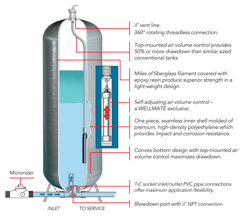

Don't forget that the AVC is located low in the tank and tries to maintain the air level so it is 2/3rds air and 1/3rd water. See pic below but realize it is only an artist's concept and not a true representation. The AVC is the black item at the bottom of the grey tube so it cannot let out air that is above the black AVC. It does most of the air removal when the pressure is down to the kick-in switch setting. As the pressure raises, the air compresses and is out of the reach of the AVC.
Since when the pump shuts off and drains back, the tank will be about half full with the rest air. When it starts and pushes all of the air out of the line, it will add it to the air that is already in the tank and as I said, will be out of the reach of the AVC.
As I mentioned in my previous post, I modified mine by raising it 12 inches so that I have more water than air.

Here is a pic of my two tanks in series. The water level (at max pressure) on the first (blue) tank is at the top of the foil bubblewrap insulation. It is designed to be almost empty when the pump turns on (hence why it lets the air out so slowly) so If a very heavy draw drops the pressure below the start pressure, air will move forward to the second (grey) tank that has the shortened AVC dip tube. Since that tank has a foot more water, air will not move forward into the iron filter and softener.
Since when the pump shuts off and drains back, the tank will less than half full with the rest air. When it starts and pushes all of the air out of the line, it will add it to the air that is already in the tank and as I said, will be out of the reach of the AVC.
You're right that would happen. I never realised that. That looks to be nearly the same tank I'm looking at - a Flexcon FLU40SQEZ. It uses the same type of AVC.
