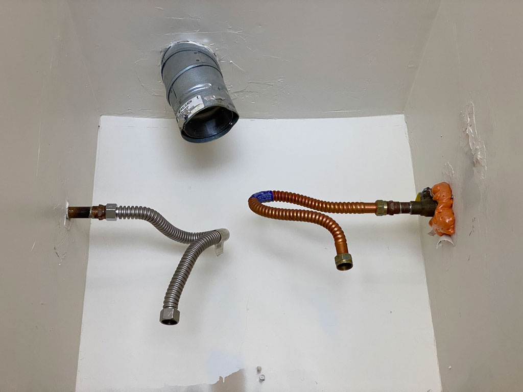

The old HWH had two simple connections: a flexible copper connector running from the cold water supply to a T-fitting above the tank where a thermal expansion tank was installed, and a flexible stainless steel connector running from the hot water outlet to the condo hot water system.

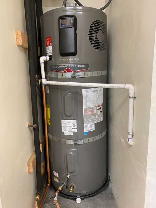

It took two flexible copper connectors and perhaps 22' of new copper piping to connect this Rheem HWH. The cold water inlet is located 5" above the floor on the front-left side of the tank, the hot water outlet is 3'-6" above the floor and further to the left from the cold water inlet. We still have a thermal expansion tank (new) but the addition of a thermostatic mixing valve so the unit can run very hot but deliver safe water to the condo. (At this time, we are only running the HWH at 120*F.)

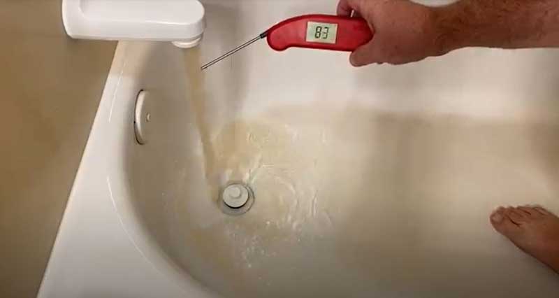

Here's the problem. Shortly after installation, we begin to notice dark orange water coming out of any hot water faucet in the condo. Turn on the hot water valve to the bathtub, a slug of clear, cold water comes out first, and as warm water arrives it turns dark orange for a few seconds. This is especially pronounced in the morning when we've not used any hot water overnight, but also happens to a lesser extent during the day when we've not used hot water for 4-6 hours.
I tried draining the tank, refilling it, draining it a second time, and refilling it. Same result the next morning.
I have sampled water from the T&P valve and it runs clear.
When asking the plumber, his response was "bad pipes in your house." That does not make sense to me because the only changes made were between the cold water inlet and the hot water outlet above the HWH, and we had no problem with discoloration before the installation.
Here are video links showing my description of the installation and the discolored water discharge.

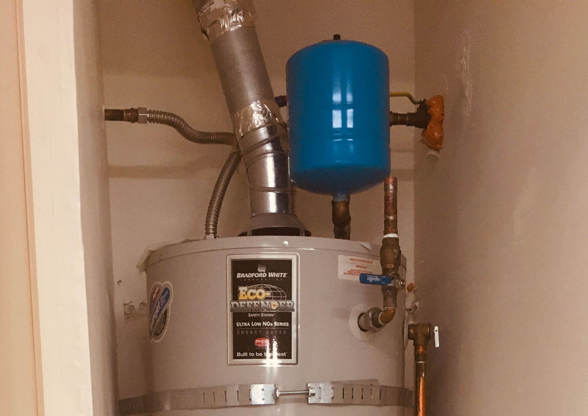

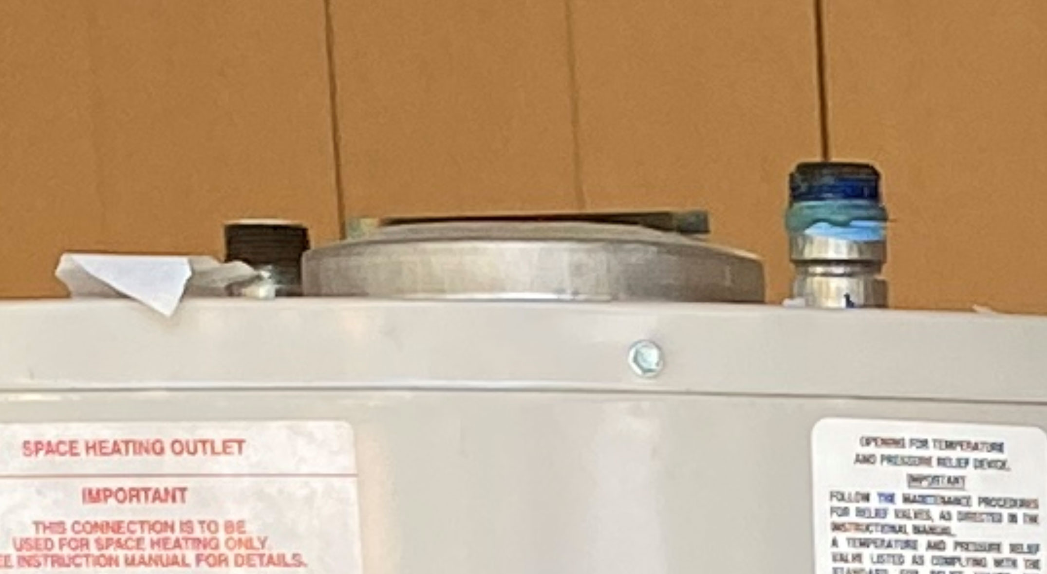

I don't know if dielectric unions were installed on the old HWH, but I have these photos taken before and after removal.

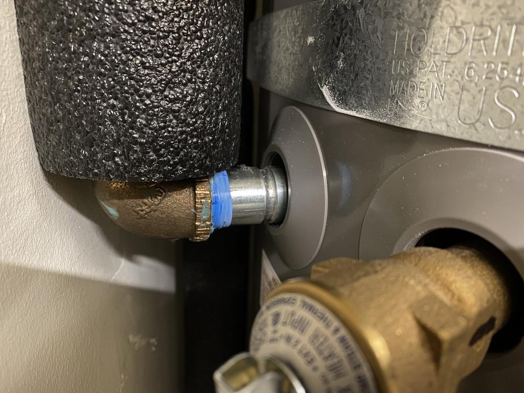

Here are photos of the new HWH connections at the cold water inlet and hot water outlet. The flexible copper connector came from Home Depot, reading the specs it says, "Eliminates the need to install an additional dielectric union" and you can see in the photo a plastic washer that separates the brass connector from the copper flex pipe.
On the hot water outlet, it's a brass elbow screwed onto a threaded copper connection (using what appears to be blue tape on each end). The flex copper connector is at the top of the pipe that connects into the thermostatic mixing valve.
Reading the specs on some of these Rheem nipples, they say, "Dielectric lining helps prevent galvanic corrosion."

Sounds like everything is correct. I don't have any other ideas. Except to check that hot and cold are not hooked up backwards -- which I'm sure you've already done. Sorry i can't be more help.

BTW, the WH in the picture is not a Rheem, It's a Bradford White.

The Bradford White is the old water heater that was replaced by the Rheem Performance Platinum ProTerra Hybrid Electric Water Heater. The photo of the Bradford White was only included when someone asked if dielectric unions were used on the old heater. Here's a photo of the Rheem:

It continues as before...when the hot water is unused for 4-6 hours or overnight, we get 3-5 seconds of discolored water at any hot water faucet after all the cold water in the line is discharged. As long as we're using hot water frequently, we don't see discoloration. It's only when the water sits for at least 4-6 hours.

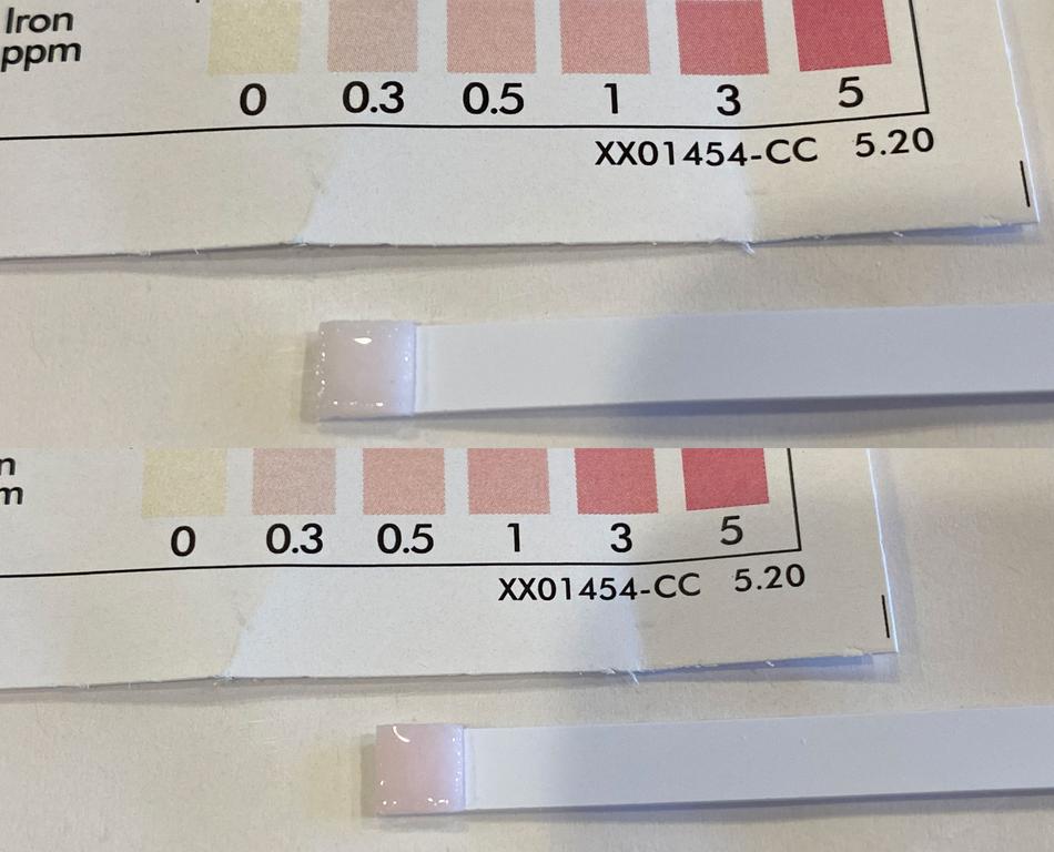

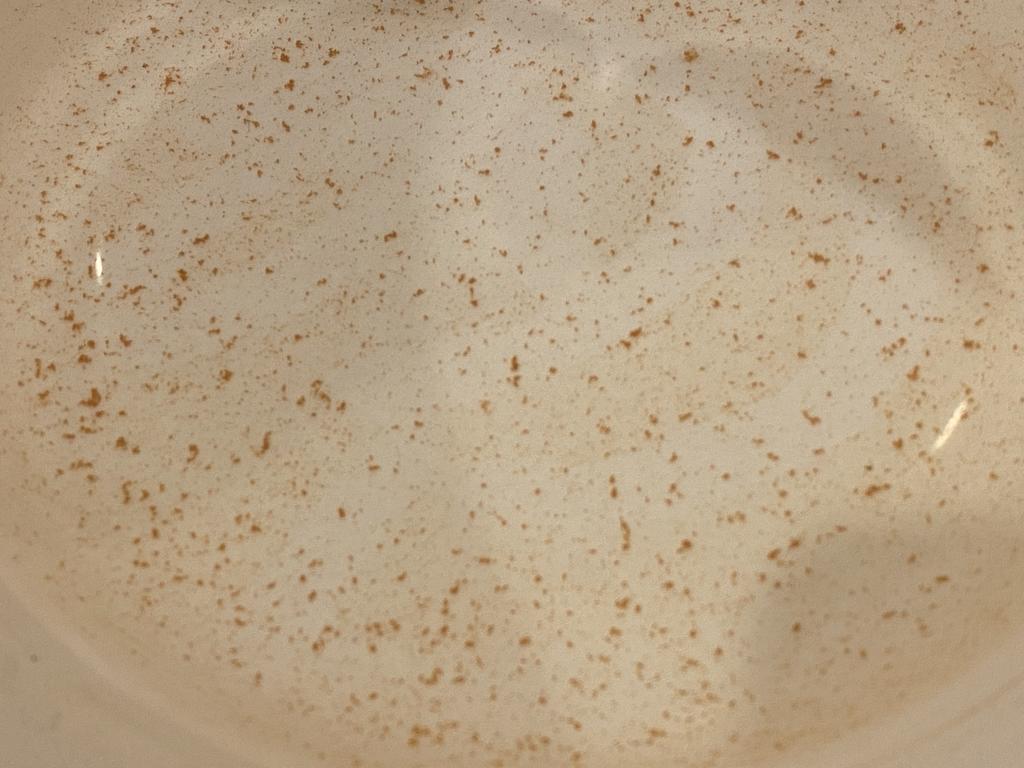

It makes me think there's a rogue galvanized pipe in the hot water system just after the HWH. I bought a cheap home water test strip kit at The Home Depot and tested both the clear cold water and the discolored hot water. Copper was in the "OK" range for both samples; iron appeared to be zero for the cold water and just slightly above zero for the hot water, so I believe it's rust in the water.
And when you let the discolored water sit for several days, it settles and looks like this:

Where is the fresh air to allow for proper combustion?
There is no combustion. This is an electric heat pump hot water heater. It uses electric elements in the tank plus a heat pump on top of the unit that uses a compressor and refrigerant to extract heat from the surrounding air and transfer that heat into the water via coils that encircle the water tank.

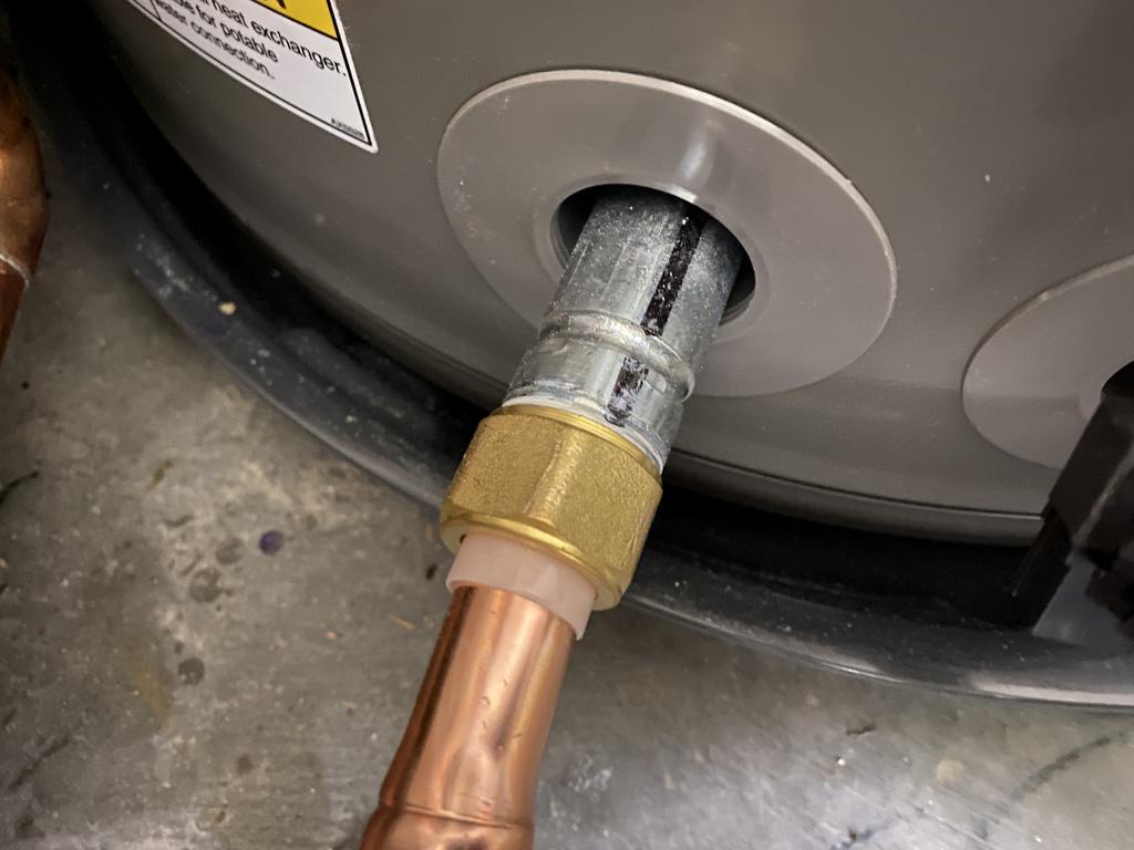

Rheem was unable to offer a solution short of replacing the entire hot water heater, which they paid for under warranty. This time I asked the plumber to connect the replacement water heater with PEX instead of copper pipes/fittings, a flexible copper connection at the cold-water-in nipple, and a brass elbow at the hot-water-out nipple.
After pulling out the problem child, just for fun the plumber unscrewed the hot-water-out nipple to reveal this:
The end of the nipple was rusting away. There were signs of rust in the J-shaped water inlet tube. The 90* brass elbow connected to the nipple had rust collecting in the bottom of the elbow. In hindsight, it seems strange to me that Rheem never recommended examination and replacement of this nipple...they just scratched their heads and went straight to complete replacement of the entire unit.

Just wanted to chime in that I had the exact same issue as you for a while after installing my tank 4 years ago. After a while it eventually stopped I guess as the end of the nipple was not exposed to enough electrolysis, maybe because enough crud prevented the water from allowing it to happen. Who knows...
Anyway, I recently believe I had an electrical surge which killed the control assembly on my tank, and since Rheem has had no boards for months and won't have any more for a while, they told me to take the whole tank back to Home Depot for exchange. I took out the heater today and found exactly the same as your last pictures. The end of both nipples was rusted, clogged, and corroded.
I believe the problem is that their pex inner lining inside the galvanized "dielectric" nipples ends before and doesn't wrap around the end of the steel pipe. If you look at other proper dielectric nipples for sale online, you can easily see that the plastic liner goes out of the pipe and increases in diameter to cover the ends of the pipe.
I'm expecting our new heater to be delivered on Monday and REALLY hope that they have solved this problem and put better dielectric plastic tips on the nipples. If they have not, I'm going to call them about this and tell them they need to give me a solution to prevent the corrosion. It's not just you and me that have experienced this. I also don't believe that you can just replace the nipples with better ones since they are sealed to the tank inside (at least I think I read that somewhere).

Is the heat pump water heater located in a closet? If so it needs to be able to circulate ambient air in and out of the closet, if not the closet air temperature will drop, and then there won’t be sufficient heat left in that air for the heat pump to remove and the recovery rate will be Even longer.
