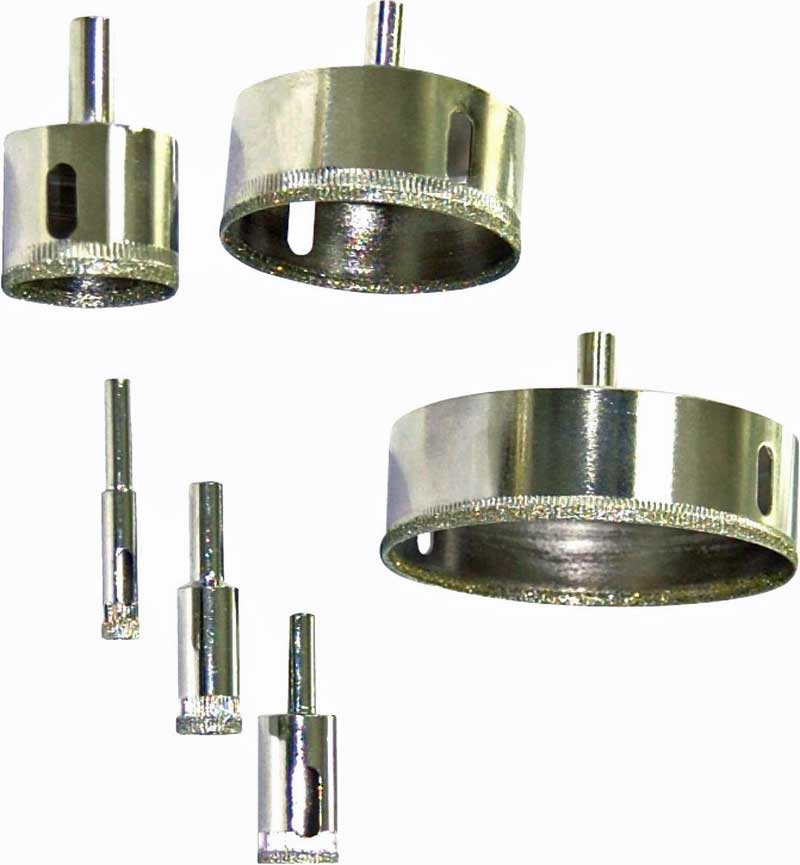

Diamond Coring Bits for cutting holes in tile.
These are the style of diamond coring bits I reference in my post here. I purchase these from my tile suppliers - last store in Vancouver I used was Ames Bros in Burnaby. They sell many sizes as does Pacific Rim and many others.
These bits need to be cool constantly - just like the arrowhead bits below.

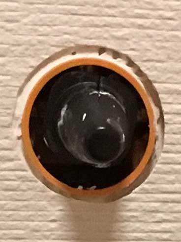

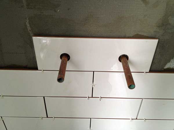

I prefer these shower fixtures to come out the center of the tile like these holes above. It is easier to design your hole to meet a corner of the tile or land on a grout joint. Then cutting the hole can be easier.
Often you need to drill four holes in a tile to cut out a square or rectangle. These are basic moves in tile work. In the picture below you see a square cut out marked and the four corners drilled.​

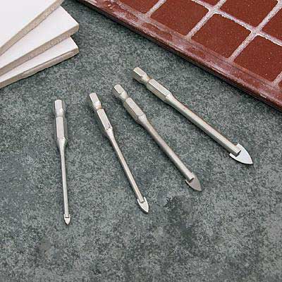

Arrow Head Drill bits (Glass and Tile) for cutting holes in tile.
I really like these glass and tile drill bits for many of the holes we drill for fasteners and anchor locations. I prefer to drill the hole smaller first and start with the tiny arrow head first.​
Then I drill out the proper size for the wall plug being used to whiled the fastener from the tile.

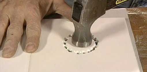

One way to make a larger hole (like for say your shower arm or shower controls) is to drill a series of smaller holes. Look at the photo below for a clearer understanding of this method.
You can see the circle of holes drilled. The hammer would be to generated a little stress between the drilled holes.
This same technique world well when hanging cement board as well.

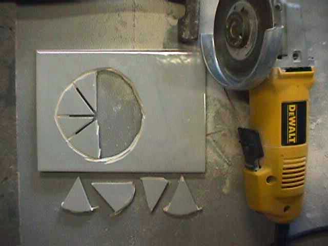

Using your Angle Grinder for drilling holes in tile
The photo above shows the game plan. The cuts on top are just to score the glaze of the tile. The real meat and potatoes of the cut happens on the back side. Mark out both sides of the tile for the cuts....
This image shows the rough circle that can be cut with just an angle grinder.

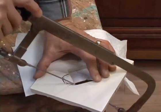

Cutting Holes in Tile by Hand
Maybe with a cheap ceramic tile. Most of todays tile do not offer up the ease of cutting shown here. In order to get that saw started a hole would have been needed to drill first a path to slide the saw blade into.

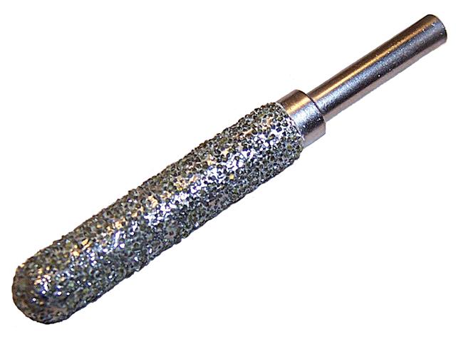

Using a RotoZip to cut holes in tile
Most every trade show I have ever been to I have seen the RotoZip tile cutter booth. If you are headed to a new trade show - slap a small porcelain tile into your pocket. Ask them to cut that when they do the product demo. Roto Zip cuts rarely work for this type of work.
Rotozip cuts DO WORK for this type of work.
The Rotozip XB-FTC1 is a 3.5 carat diamond bit and I have successfully used it with accuracy to cut into tiles.
It's accurate enough so escutcheons and toilets cover it fine, I don't need to be stocking up on every size of coring bits.
Coring bits are necessary only if the tile will remain EXPOSED without an escutcheon or similiar covering it.
