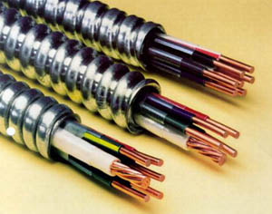

Eh ... Sorry to interrupt ..... What is MC? New at this stuff, still learning.
Metal-clad.
Around here, people call it BX... I'm not sure why.
Looks like this:
