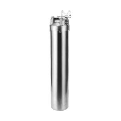

Your well casing is steel, it will not oxidize enough to produce rust noticeable in a day or week, especially with your length of pipe. If casing were cast iron, as in the pipes supplying NYC water, you might get a rust every day. Ferric iron is your visible iron (rust) issue, not from the well pipe but from your aquifer. Filtering is your only option for ferric iron, it will not be affected by chlorine, permanganate, or peroxide, those chemical are for the invisible ferrous iron. Katalox light. in the proper sized tank, will filter particles of ferric iron down to <3microns, and oxidize ferrous iron and any heavy metal compounds from your water. Sufficient back washing is needed and a large whole house pre-filter should be installed ahead of the Katalox filter. It is far cheaper to change a pleated/cartridge filter than to change overloaded Katalox media. Also with ferric iron comes iron bateria, harmless but it can clog filters and filter media.
Is you present filter this size or bigger with a 10 micron or less filter inside ? stainless filter are best
