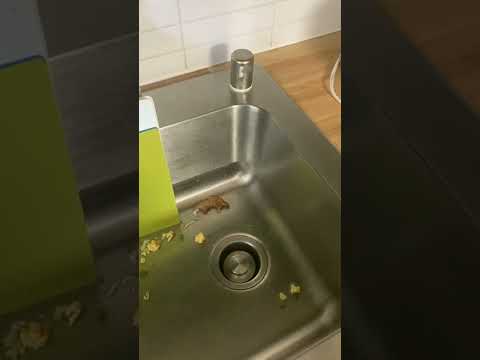

When my dishwasher drains, there is a loud dishwasher drain noise. It's a gurgling sound emanating mostly from the airgap. The dishwasher drains to the airgap, which drains to a junction at the top of the disposal.
Here's a YouTube link to the offending sound. At the end, I cover it to show noise dampening.
I get that there's gonna be "a" noise, but this is so noisy that we have to pause the TV and wait twenty seconds. I've been trying to diagnose it and fix it myself for two days with no real luck. I'm willing to call a plumber but the ones I've spoken to suggest all the things I've tried and I'm hesitant to pay someone hundreds to go fishing for a few hours trying to solve it themselves.

If I cover the airgap with my hand the sound is 80% muffled so I know this is the source of the sound and it's to do with the way the water is pouring through the system but I both cannot find a fault in the setup nor does it seem that everyone else in the world is living with this noise.

I had to remove the "feature=share" part of the URL to see the video. It seems to me just an air gap function. Air-gap's are driven by local codes. I would just connect the drain hose directly to the disposal and give it a try. I have a dead silent Bosch directly tied to the disposal and you can hardly hear the machine drain. To get the machine as quiet as possible, the water is pumped at a very slow rate.

Sounds pretty normal (sorry). Dunno if it's an option for you, but here in WI, where air gaps are also required, we have the option of draining a dishwasher right to a stand pipe under the sink, too. This requires the kitchen sink line to be 2" instead of 1 1/2" (1 1/2" traps for the dw, and sink going into a 2" branch). In new builds, we always put them in this way, and since houses mostly have basements, it's not crazy complicated to upsize older drains for a bit of $$$. If you're on slab, and it wasn't run as 2", you'd be out of luck outside of a complete kitchen make over.
This keeps the sound in your cabinet, and helps muffle it a lot. Doesn't disturb the kitchen sink trap either, so no echo in those big steal sinks.

Have you checked your dishwasher's backflow preventer or check valve? We had a similar gurgling problem, although not from an air gap (our house doesn't have one). Each time we used the dishwasher we'd get loud gurgling noises when the pump drained. I finally took the dishwasher apart and found that the built-in check valve right before the pump had completely eroded. Was able to replace it with a spring check valve for a few dollars and now we have no more gurgling. This might not be what's causing your gurgling issues, but if it is, it's usually a cheap and easy fix.
