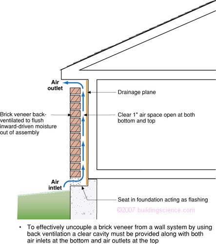

Creating retrofit weep/vent holes doesn't take a rocket science degree or a journeyman level of fine craft. There are retrofit weep hole screens for keeping critters from using the weeps & vents as the front door to their cavity-condo.
A weep every 3-4 bricks (24-32") on the course of bricks one brick height above walkway surface ( so that the walkway doesn't drain into the cavity in a heavy rain) and a corresponding vent just below the overhanging corbel/sill course allows it to convection-vent to the outdoors. A whole-house brick veneer view would look like this, but even the ~18" of height under the bay window will provide a modest rate of convective air purging of the cavity (way better than what you have now, anyway.)
When opening up the brick veneer with weep vents the air tightness of the rest becomes even more critical from a heat & moisture movement path perspective. It dries out the cavity, but it's important that it not become a wind-tunnel too. When sealing the band joist to the framing & subfloor with caulk, be sure to seal the seams of the odd-angle joints of the band joist visible in your photo too, not just the floor joist to the band joist, and joist to subfloor, etc.
