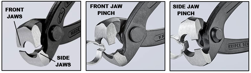

Cinch clamps, with side jaw pinch, look to me as if they could be considered also.
