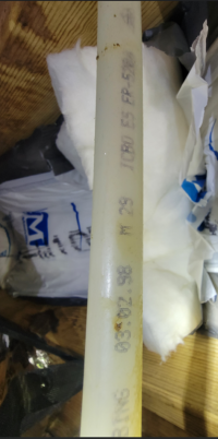

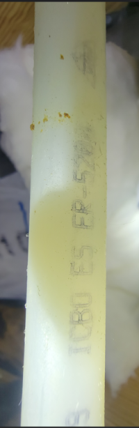

Hello. I've done my due diligence and am looking for suggestions/input on replacing outdoor spigot (attached images) & what type of water line is running to it (no PEX A or B label is visible and line is transluscent). I'm not a plumber so consider my experience level with this project a zero out of 5.
Some other notes:
REPLACEMENT SILLCOCK (listed in order of preference, open to advice, suggestions, warnings, etc.)
- OPTION 1: Aquor V1+ 8" hydrant
- OPTION 2: Woodford Model 17 8-in L x 1/2-in Copper Sweat Brass Anti-siphon Push/Pull Sillcock
- OPTION 3: Prier Products Diamond 8-in L x 1/2-in MIP Brass Anti-siphon Half Turn Sillcock
- No Sharkbite products
- I want to use expansion option (if this is PEX A only) or clamp, not crimp
- preference for adapter is poly plastic but water flow will be restricted so am planning on using C69300 brass alloy/eco to minimize/prevent zinc decalcification (current condition in pics)
CURRENT SETUP
- estimated 4-6" valve stem (replacement will be 8")
- visible labeling shows PSI 200degF, Potable Tubing, (install date), M 29, ICBO ES ER-5200
- install date says 03:02:98 with ICBO/Intl Conf of Bdg Officials (now ICC)
- crimped
Thank you for any thoughts and links to useful info.
