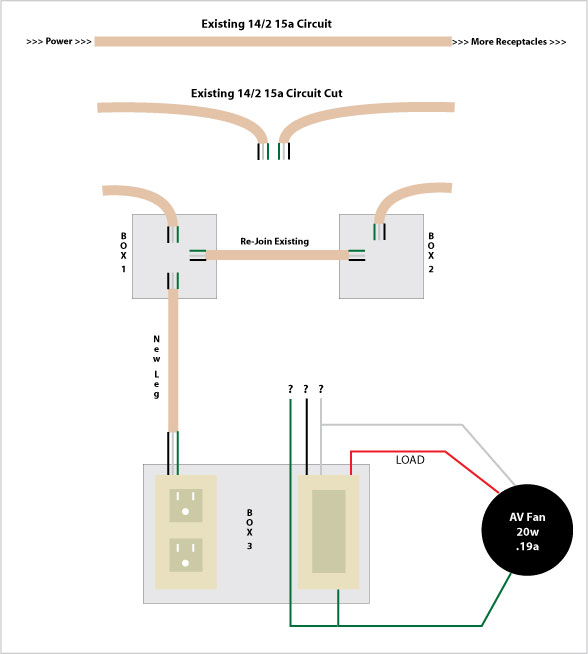

Hello, I would appreciate any pro electricians to check my proposed wiring.
I need to add a new receptacle and switch to my AV closet by tapping into an existing circuit.
The receptacle will be to power the AV gear, and the switch will turn on/off a cooling fan.
Assuming that there are no wiring errors in the attached drawing, then:
Question - Where should I wire the switch to for power? Box1, Box2, or directly to the receptacle in Box3?
*NOTE: This is a Home Automation switch, so it has Black, White, Red, and Green wires

The answer is None of the Above. I would splice pigtails from receptacle and switch to incoming 14/2 cable in Box 3.
1,193
At box three, join the whites from your fan and the supply together with a pigtail. Run the pigtail into the outlet. Take the supply to the receptacle and two pigtails and join them, run one to the receptacle and the other to one terminal of the switch. Tie all of the grounds together from the fan, receptacle and add as many pigtails as needed to connect to the receptacle and the switch (if it has one).
basically, the switch has only two terminals that get connected when closed. You run the hot line to one, and the other side goes to the load you're trying to control. You might be able to get by without pigtails, depending on how many screw connections there are on the receptacle.

Now I'm more confused. I thought that a drawing would help visualize my setup. Here is another drawing.
Notes:
* Existing Romex is approximately 2' from Box 3, and once cut there will not be enough slack to do anything but box each end.
* This is NOT a regular switch. It has 4 permanent wires coming out BWRG, there are NO terminals.
http://www.smarthome.com/2476S/SwitchLinc-Relay-INSTEON-Remote-Control-On-Off-Switch-Non-Dimming-White/p.aspx
Let me re-ask the question:
1) Is the shown new config2 correct.
2) If there is another way, what is it, and why is it better or more correct.
3) Goal = New leg works, and my house won't burn down.
I'm not an electrician, so please keep answers at novice level using colors and/or drawings if possible.
Many Thanks

If I understand box 1 and two are being installed to insert the splice in the existing cable with box 3 being the new receptacle and switch.
Everything looks good
Black to black
White to white
Ground to ground
And the switch as drawn

Yes, that is correct. There is NOT enough slack to re-join the original Romex in only one box, so having 2 boxes seemed to be the only way. It doesn't need to look pretty, since the whole config is in the attic.
The other LEG coming out of BOX1 is all the new wiring servicing the outlet, switch, and fan.
