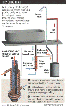

I replaced our 40gal electric tank water heater a year ago. It doesn't seem to be enough water to make it thru a longer shower as the water gets cold.
I am thinking of supplementing the tank with a small electric tankless prior to the tank so the water is preheated before going into the tank.
Can anyone tell me if this is a good idea or if there is another option that would be more effective? I don't want to reduce the pressure so am concerned that too small a tankless would cause more harm than good.

If it's primarily showering performance you're after, if you have at least 4' of vertical drain downstream of the shower you can cut in a drainwater heat recovery heat exchanger. With a 4" x 48" or 3" x 60" or larger it will at least double your showering capacity, but it will cut your water heating energy use, since it's recovering half or more of the heat that was going down the drain and putting it into the incoming water stream(s). The highest performance is achieved when the potable output of the heat exchanger feeds both the cold side of the shower, AND the cold feed of the hot water heater, but if you have to choose just one or the other, make it feed the water heater.
By delivering 70-80F water into both the hot water heater and cold side of the shower, you end up mixing a larger fraction of cold water at the shower, and the hot water heater only needs to raise the temperature 25-35F to hit showering temperatures, not 50-70F. With a typical gas hot water heater burner and a low flow shower head the showering times can be nearly infinite, but with a typical electric tank it'll still eventually drop to below body temp.

It's not about the net present value of energy cost savings- it's about increasing showering capacity.
Drainwater heat recovery been proven effective for significantly increasing showering capacity for electric tanks in retrofits in Canada, a country which SFAIK uses the same laws of physics as the rest of the known universe. :)
The amount of the showering time increase with electric tanks depends on the incoming water temp, the storage temp, the shower flow, and to a lesser extent the power rating of the heating elements.

There's nobody here asking them "... to pay themselves off...", only to increase the showering capacity.
Aging tests on first-generation units done by the US DOE back in the 1980s indicate that heat transfer efficiency would drop to about 75% of it's day-1 efficiency after being in service somewhere between 30-40 years. That means a unit delivering 55% steady-state energy return at 2.5 gpm drops to about 40% return after a few decades, which is still enough.
The amount of heat lost to the drain pluming through the "extra" length of another story of height in a 7-8 minute shower is remarkably small, even with cast-iron drain. It's really barely more than the amount of heat necessary to raise the temperature of that additional 10' of drain from 70F (room temp) to 90-100F (drain water temp), which is a function of it's thermal mass. The fraction of total heat being radiated off the 90-100F pipe is miniscule.

Again, it's not about the net present value of future energy use savings against the installed cost of the heat exchagner. Rather, it's about gaining the showering capacity without taking up more space or throwing away a perfectly good hot water tank for a bigger one. Compared to the installed cost of a tankless big enough to make up the difference (the original question) it's comparable (or cheaper if done as a DIY.)
There's also no "payback" on raising the storage temperature which was my original suggestion.
Nor is there "payback" on installing a second tank in parallel. Though the initial cost of a second tank may be lower than a drainwater heat exchanger, it takes more space, and you'll go through three or four of those before the heat exchanger would crap out.
Oh yeah- AND it would use more energy. From a lifecycle cost point of view compare the installed cost of 2-3 replacement tanks plus the difference in energy use cost and it's not hard to come up with discount rates and energy price inflation rates that would make it financially rational, even if purely on the energy savings alone it doesn't "pay".
If you're only planning to live there another year, find a low-cost gym membership and shower there! :)
If you plan to spend a couple decades there, do what's rational for the longer term. The "install it and forget it" aspect of the long lifecycle is itself appealing.
The embodied CO2 of the heat exchanger is roughly 2-6x that of it's copper weight. (source1, source 2 ) The shipping weight of a 3" x 60" or 4" x 48" is 25-35lbs, so pessimistically it's 35lbs x 6= 210 lbs of CO2. Burning natural gas is worth about 11.7lbs of CO2 emissions per therm, so the lifecycle embodied carbon emissions of the heat exchanger it's no worse than lighting off (210lbs/11.7=) 18 therms of natural gas.
If heating hot water with natural gas it'll save a typical showing family of four about 1.5-3x that amount of fuel every year. But if you're heating hot water with all hydro grid power in the Pacific Northwest it may have a net-lifecycle carbon footprint, but not a huge one. Assuming a 40 year lifecycle that's about 5lbs of carbon emissions per year, which is the same order of magnitude of climate damage of the average human's flatulence-methane emissions per year (about 2lbs of CO2-equivalent.)
