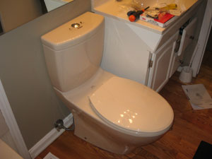

My Aquia Leaks
I had an Toto Aquia II installed 'professionally' a few weeks ago. It seems to work fine normally but has leaked twice on me - from the bottom of the toilet, it doesn't overflow through the bowl.
The contractors original blamed it by rough iron pipes. A blockage it not out of the question, but should it be leaking out of the bottom??
Does this sound like a case of a bad or improper seal?
Are there any 'tricky' steps in installing an Aquia II that are different from a normal toilet install that could be missed??
Thanks.
Machabs9
Canada
Please elaborate
Thanks for the response Terry.
With a good seal, wouldn't even a main line back-up just overflow the bowl and not leak under the toilet onto the floor?
The leaking occurred after several flushes within a 30 minute period.
Could this be a slow draining main line?
Might I have two problems... the seal and main line back-up/slow drain?

These adapters are installed with a seal at the flange.
We normally use wax.
If you have a main line backup, don't expect wax to hold very much head pressure.
If it is a backup, the toilet flange is normally the lowest point in the home, followed by tubs and showers.
It's easy enough to pop the bowl off and check the flange seal though.

Resolution
It turns out there were two problem at play here.
1) There was a partial main line blockage.
2) Also the wax seal used was not sufficient. I was told this model needs an extra tall wax seal. My contractors originally used a regular wax, for the fix they used a regular wax seal on top of a wax seal with neoprene(?) base. This double tall wax seal seem to do the trick, but only the next main line back-up will tell me sure. Does this sound right that an extra tall was seal is need for the Aquia II?
Anytime the flange is lower then the finished floor, you need more wax.
Unless the flange is installed "over" the floor, it takes more then a single wax ring.
For any bowl or toilet.
But then any plumber knows that.
A handyman might not know that.
