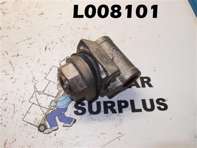

Hello again all. I have found that the pitless adapter is leaking, looks very much like it's leaking at the o'ring. The problem is, it's about 4 feet down the well pipe so I can't actually reach it by hand. Digging out from the outside is impossible.
When I pull the pitless the part that is attached to the well pipe does not have the o'ring on it......so.....how do I get the o'ring out of the other part of hte pitless when it's so far down the pipe ? Any suggestions ?
Supposing I do get it out, how do I put another one in without dropping at least ten of them down the well first....
Any ideas ?

A missing or defective o-ring on the inside of the casing would cause water to drop down the well-- not into the yard.
If you are getting leaking to the yard, that would need fixing outside. Your photo of the pitless is not sharp. Does the pitless have a big hump outside of the casing, and is that hump welded in place?
Is that pitless picture of the same hole that the tree picture shows? Your well person is going to need to do some serious cutting of that tree, I would think.
When you lift the pitless inside, what does it look like?

Hi Reach4, a bit more background.
I have city water but this well is still operational although disconnected indoors. When I tried to test it I found that everything worked but I got no water to the tank. So, I tested a few things and found everything was ok so I had to have a leak. Turns out the leak is in the pipe between the pitless and the house and is impossible to "repair". So, I dug down outside the casing and cut the pipe running to the house and instead replaced it with a capped "standpipe" at ground level right next to the well casing. The plan was to run a pipe above ground from the stand pipe to the tank to test it and to see if the well was sufficient to run an irrigation system. For that I need to know GPM, pressure etc to see if this is even feasible. Anyway, all of this was months ago and I just got back to it today. However, somehow I noticed that I left the well pump breaker on for a month (my electricity bill was much higher than usual) and I found this when I looked at the panel .... ugh. So.....if I had been pumping water into the capped pipe and the pitless o'ring was doing it's job then surely I would have a small swimming pool in my yard....but I didn't, which leads me to think that the pumped water must have been leaking at the pitless and down the inside of the casing. Odly enough the pump still worked despite being run for a month straight with who knows how much back pressure, when I pulled the pitless up and turned the pump on.....water came gushing out of the pitless from the well.
So, I have to at least replace the o'ring as I doubt it has ever been done and the well hasn't been touched for at least 15 years until I started trying to use it.
The pitless adapter I have looks something like this although I don't know the size for sure. I measured the size of the hole in the part attached to the well pipe and it was about 1 3/8" diameter but I assume the o'ring will need to be bigger than that.
Correction, I just went and pulled it again and it says Martinson B10 on it, so it's this one.
I searched for Martinson B10 and found this...
You were posting on this, thread post #28 you say this needs an L1 o'ring. Now I have looked everywhere and I can't find them for sale or even the specs of them. Do you know anywhere I can buy a few ?
So, assuming I can get some L1 o'rings how do you suggest I replace it given that it's out of reach down the well casing and I can't access it from outside the casing.
Presumably removing the old one will be relatively easy, use a pick on the end of a broom handle or something like that.
Putting the new one in place will be more difficult. I was thinking of lubing it up with some kind of grease and "gluing" it to a broom handle with the grease (or something like that) then gently lower it down the casing and press it into place.....maybe it goes first time or maybe I lose a few down the well until I succeed.
Do you have any other suggestions ?
