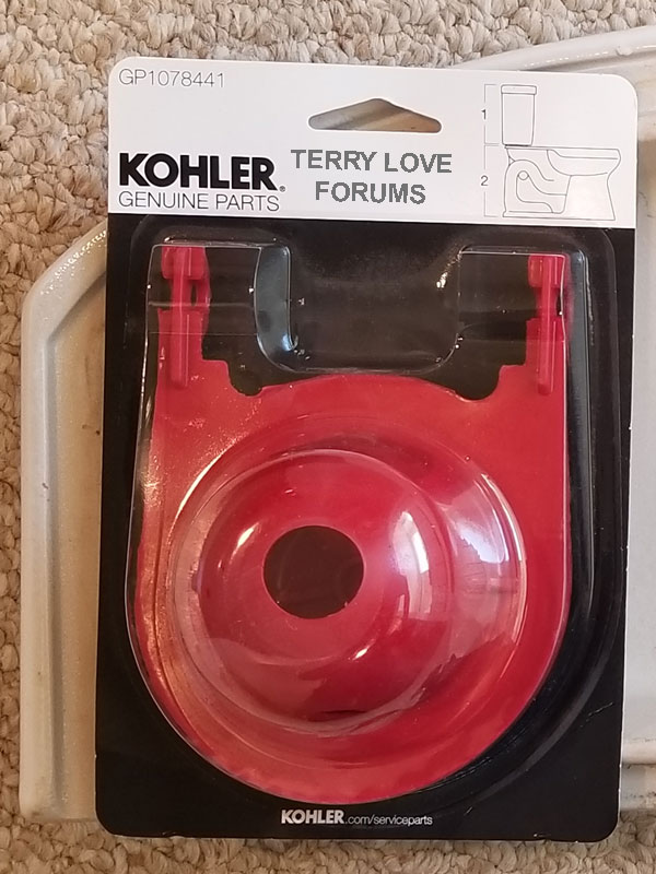

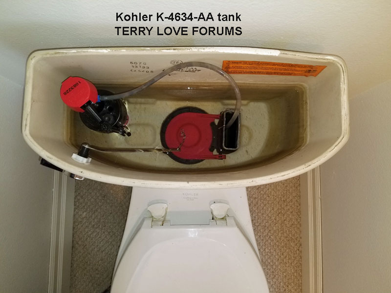

Man, I'm wondering if I have the same toilet as others do. When we built the house, I specified to the GC & plumber that we needed good flushing toilets. Mine are model #4634aa 1.6 gallon and are from around 2005. I have at least three clogging issues a month between them. The most frustrating thing is that I have to snake them all the time since the elongated bowl won't let you use a plunger....at least not without soaking yourself in some nice brown water :(
It seems that mine are always getting clogged on the lip of the bottom of the trap. Still scratching my head over why they put a lip at the bottom of the trap.
K-4634-AA tank and K-4286 bowl
32,771
1,191
A well performing toilet has a nice clean, smooth trapway. Obviously, yours don't conform to that premise. It takes more than a well designed trapway, though, which includes good bowl wash and reliable siphon action.
