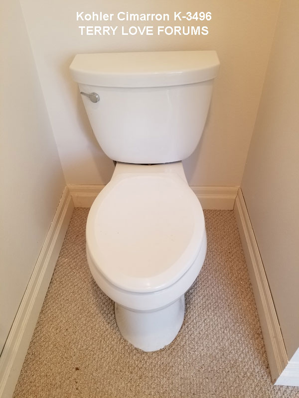

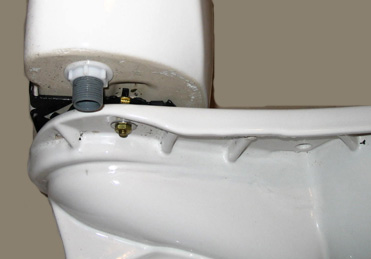

I bought and installed a Kohler Cimarron toilet about a month ago. The spec sheet calls for the tank to be 3/4" off the wall with a 12 inch offset. My tank is about 2 1/4" offthe wall with the 12 inch offset. I guess we ill live with it. Walls are plumb so that is not an issue. Toilet flushs good but does not clean well at all. This seems to be a complaint of other buyers as well. As Karen H states in her comment, we now keep the toilet brush handy.

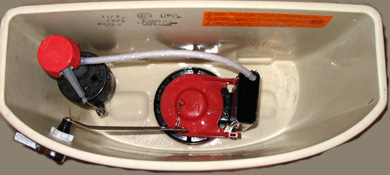

I installed this toilet in January 2006. It took me about two hours to install. I have not had an instance of it clogging up, but some of the comments were correct about it not cleansing the back portion, which really did not give me a problem. I noticed that with the tank lid off the valve would close before the entire tank was emptied, but so far has not been a problem with solid waste. If I feel it needs more water I just hold the handle down and count to three.

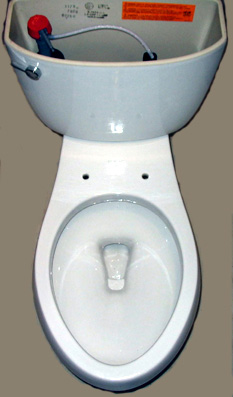

I also installed a Kohler Cimarron back in August 2004. I liked the extra height, and the style. It also did a great job disposing of solids. But the rinse was terrible. I even tried the bowl cleaner with Teflon, but water can't rinse away what it doesn't touch.
I have a HORRIBLE IRRITABLE bowel, so a toilet that flushes and rinses well is essential. After reading the messages on this site and Terry's Report on Low Flow Toilets, I replaced the Cimarron with a Toto Drake ADA Height model and have had no problems with rinsing or clogging.
