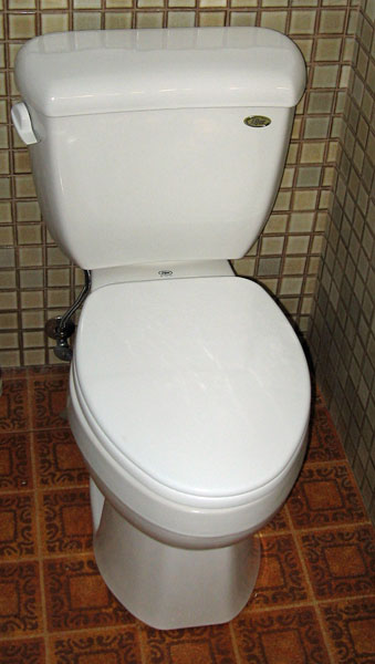

Here's what I just experienced:
Customer tried setting his new Eljer Titan toilet numerous times, I believe he used 9 wax rings in the event of pulling it up every time he set it.
Kept leaking on the left side of toilet and that is why I was called out to set the toilet.
I reworked the closet flange and set it to industry standard and there is no room for error for my workmanship involving this closet flange.
I set the toilet, leaking on the left side.
I disconnected the toilet, removed water from it, pulled the toilet and sure enough, my wax ring properly compressed with the standard tolerance that is given when a toilet is properly set.
The customer and I took the toilet into the garage and straddled it over a large plastic tub as I instructed him to fill the tank like a normal operation of filling.
When flushed, water came out of discharge opening along with a steady small stream of water 2" away from the left side bolt hole.
Could not find a starting or ending crack to signify an overtightening of the toilet to flange but did find a small pock mark in the finish where the letter "A" is stamped into the porcelain that seems to be the source of the leak.
The customer has one full day of frustration plus my $150 to find out that his toilet I'm sure by 99% accurracy that workmanship is to blame, not installer error.
He now has to take that toilet bowl back, get a refund and buy another bowl and do this project himself as he doesn't want to pay me twice to install the toilet that has been installed now, 9 times in a 24 hour period. :eek:

It does leak after 3 days?
I thought using the Waxless seal would prevent the toilet from leaking, but after 3 days, it did leak last night. My wife was glad that I didn't get all 3 for our bathrooms. This is the weirdest problem for this toilet or with any toilet. :confused:
Cheers,
3,482
Not so wierd with a Titan.
That is what people have been reporting about it.
I don't have those issues with the Toto Drake. And if I pull bowls from the box and show someone the Titan and the Toto, well........nobody buys the Titan.
You may try removing the bowl and pushing the waxless onto the horn of the bowl.
Plumbers don't follow the lousy instructions on the box, they push the adapter onto the bowl first.
ltooz_audis
Fremont, CA
Thanks for the tip Terry, I think Titan has designed flaws built in :) Of course, if it's the same price as Toto, I'm sure the Toto Drake will win hands down. I think I got it fixed.
